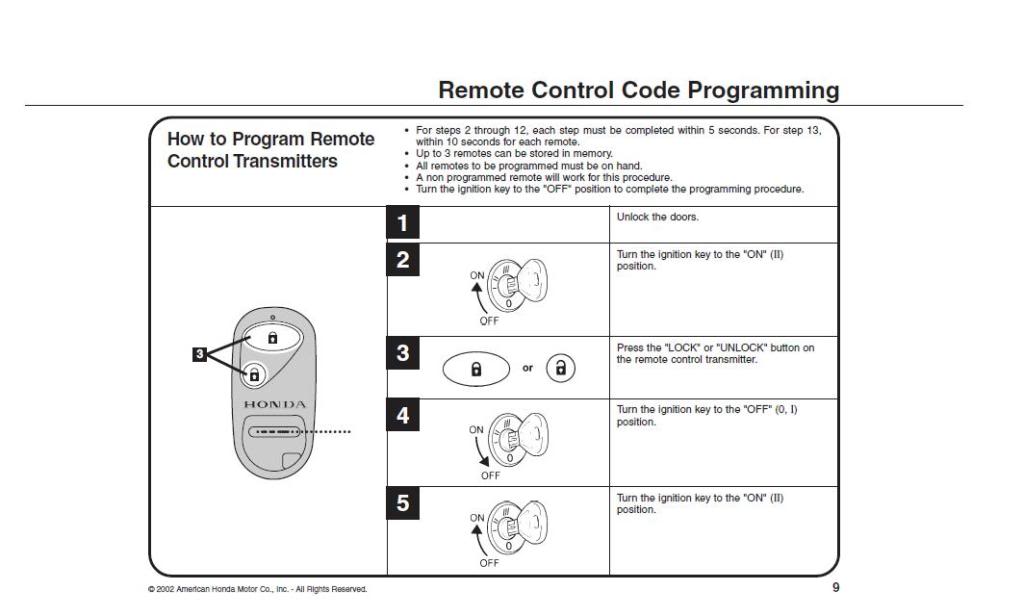

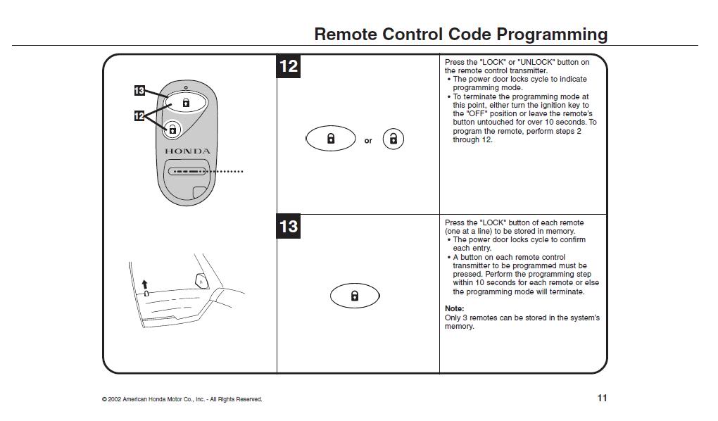

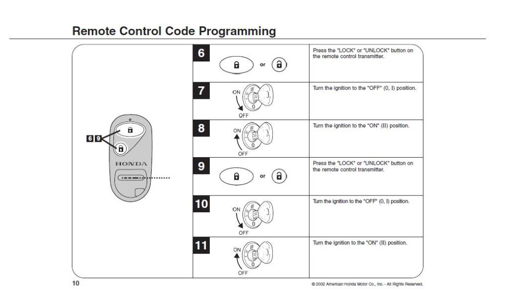

I only have a single key. If the car had remote entry, can I buy and reprogram new key fobs for it?

I am pretty sure that for 96-97 and possibly 98, Keyless entry only works if the Factory OEM radio is still installed. If there is an aftermarket stereo installed, and the previous owner did not leave the OEM radio hidden in the dash somewhere with the keyless board on it still connected then you wont have keyless entry.
Here is the part# for the remote keyfob
39950-S01-A01 - Honda TRANSMITTER, KEYLESS ENTRY CIPHER
And how to program it
