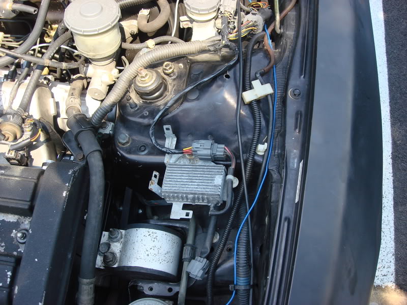

you dont necessarily need an oil temp gauge. Also I would look into getting an ODB1 chipped and socketed ECU instead of the E-Manage. Its easier to get tuned with Hondata or Crome.
Also try your local junk yard and look for a resister box. I got mine from my junk yard for $12. Any ODB0 Honda with Multi Port Injection (4 injectors) will have a resistor box, heres what mine looks like:

I dont understand the fear everyone seems to have for running/installing a resistor box. If you can solder, and match colors, its really no big deal.
As Kev mentioned, taking that route can save you a lot of money and keep you running strong.
Check the DIY section for my Turbo write up, pretty sure theres a m4d tYte diagram of how to wire in the box
