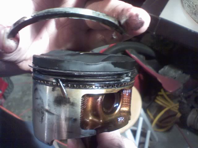

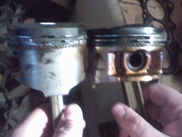

well i didnt spend enough... i tore a vac line on my wastegate so i had a boost spike of 17 psi according to the data log on my s300 and blew the head gasket in the process....
so i orderd a .051 cometic head gasket and a set of ARP head bolts.... i was pretty pissed it happend the night before i was supossed to have it dyno tuned.... so the final results will have to wait a little bit

2 cracked ring lands and a blown headgasket...... it's time for some forged 8.5:1 pistons
