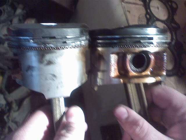

this is what happened to me when i tore a wastegate line ..... stock ringlands say bye bye
this was on a tdo4h setup..... i ended up doing a full bottom end build and now i'm running 13 psi on a tdo5h and made 270 WHP with 252 torque
in the spring i'll be changing to a .50 or .57 trim with a external gate and am hoping for 300 wheel
