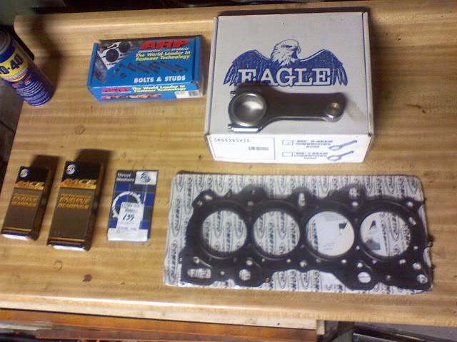

ok i'm gettinng ready to order my slugs.... iv'e decided on JE pistons and eagle rods ..... i'm kind or unsure on what CR to run .... i dont know if i want 9.0:1 or 8.5:1..... i'm more concernerd with what my static compression is gonna be..... any input???
i also did ACL rod and main bearings....

Personaly, Id go with 9.0:1 set. Itll give you a lil more power out of boost, which will make stop and go driving a lil more tolerable. Itll also make it a bit easier to get to your power goal. One more thing to consider is that with more compression the engine will take in more air, which will exhale more air, which will spool a turbo faster.

Default RE: rebuild for 14psi
i have everything but my pistons.... i orederd em last week and they should be here tuesday or wednsday...
i also went 20 over cause i had some taper in the cylinders...... i'm getting ancy..... i want boost
