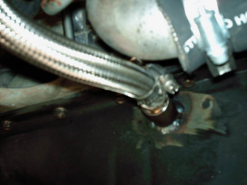

Drill a hole and find a nut that will thread onto the return line fitting. Then weld it on. Heres what I did.

I ended up buying an alumnium bung. 1/2" pipe thread. I'm gonna end up taking it to the high-performance welding instructor and have him tig it on for me. Since I don't know how to tig yet!
