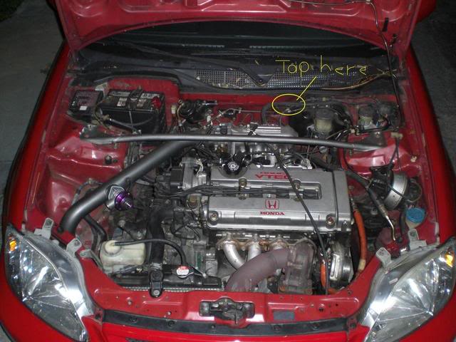

im new to the turbo game i need to know how to set up the vacum lines

for the wastegate and bov

Connect the wastegate nipple to a vacuum source. Connect the bov nipple to a vacuum source. Done.

what do you mean by thevacuum source

You can do it one of two ways, get plastic T fittings and tap into a vacuum line off of the intake manifold or buy a vacuum manifold which might make things a little easier and look a little better.

This is your brake booster line. You can tap a vacuum manifold into this and then run all of your vacuum lines to the vacuum manifold. simple enough.
I prefer the cluster of unorganized vac lines that tie into each other/random sources off the intake manifold. You should probably go the vacuum manifold route.
Old Jun 19, 2008 | 04:13 AM
Default RE: turbo vacum lines
Don't go tapping into random lines. Spend $40 and get one of these..
http://cgi.ebay.com/ebaymotors/Golde...spagenameZWDVW
Run it inline with the brake booster
