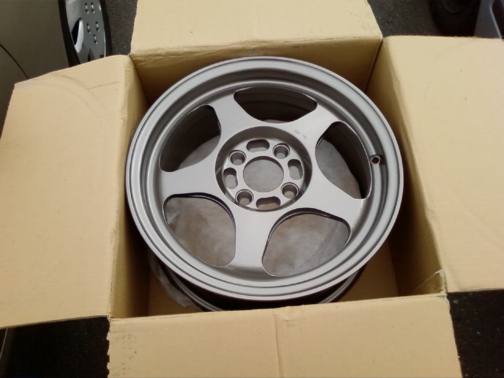

Now these are 15x6.5 what size tires do i neded

What are they 4 bolt 100mm?

wen u puttin those babies on? i cant help u with the tire question but i wanna see them on the car!!! lol

as soon as i can afford tires they are gonna be on

go here enter your info and it will tell you the tire size after you select a similar rim.

I need 195x50r15 @60 the spedo will say 59.9

Get some Kumho Ecstas I've heard good things of these tires and they're not bad in price when my nitto's wear out im gonna get some. Heres a link.

for a 15x6.5 rim, you can get:
195/55/R15 (better comfort)
205/50/R15 (better performance)
those are recommended

Even 50mm is a pretty thick side wall. I have 40mm and I'm gonna get a 45mm cuz that is way to bumpy.

the 50 does not refer to milimeter it is a percentage of the tread width and i am coming from a 175x70x13 the closest is a 195x50x15as informed by 1010tires.com thank you tony for the info
