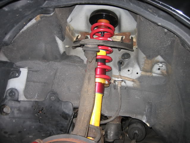

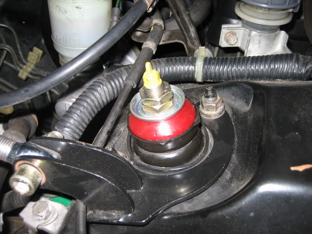

thanks for the kind comments everyone! yeah Koni yellow sports and Ground Controls with custom rates, 450in/lbs front 550in/lbs rear.
took the front suspension apart again today because i think i was hitting the bump stops on hard turns so i cut them a little more. got a couple pics of the suspension.
