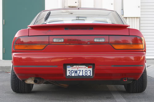

hey, a**hole... guess what?
I'm not making an educated f**king guess here, I'm speaking from experience.
That low and no premature or uneven tire wear with over 5k miles on the tires. And guess what... I was running 3* of negative camber according to the guy that aligned it. So I guess that blows some giant a** holes through your theory, now doesn't it?
Oh, and try tucking tires on 7" wide wheels with no camber... and have fun crinkling your quarter panels doing it.
