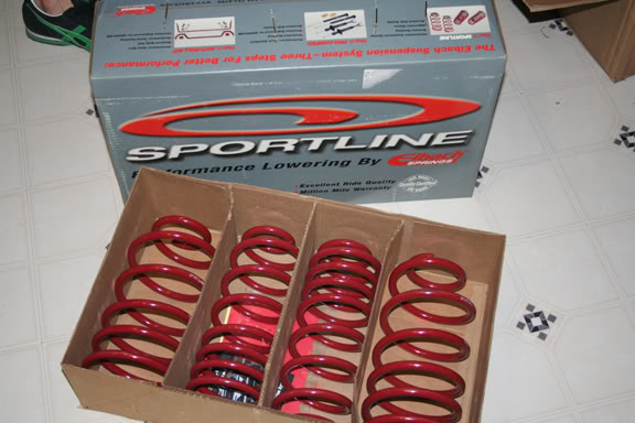

the equipment

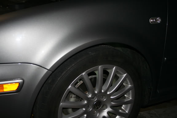

front wheel pre-drop

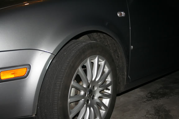

front wheel post-drop

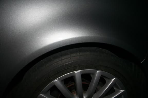

less wheel gap makes me happy. = D

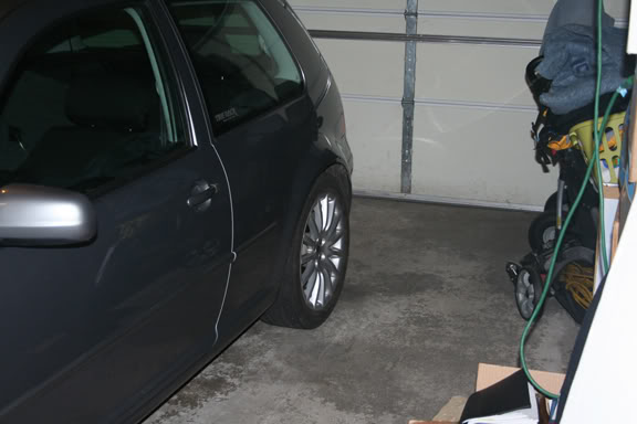

sittin pretty. = )
more to come when the springs settle in.
