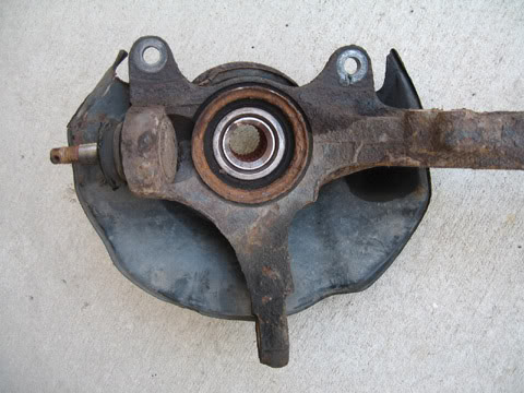

So I got the steering hub removed. Now I suppose I just need to get a new bearing from the parts store and find a place that can do the work for me...

Any machine shop should be able to do it. I don't know if you have a Lee Auto Parts in your area, but they are a parts shop and a machine shop. You will have to press the hub off of the steering knuckle. I couldn't find any more details on how the actual bearings come off but the machine shop should know more about this.
