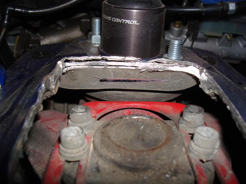

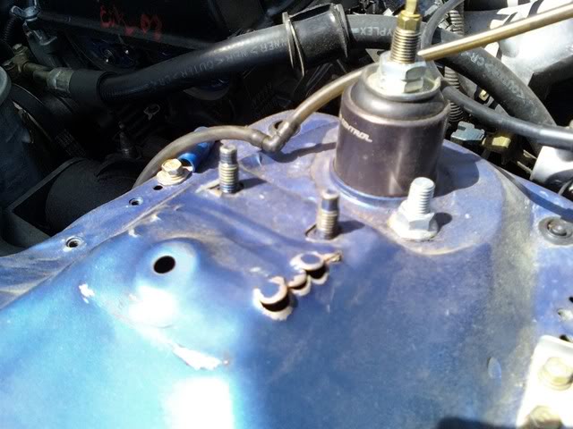

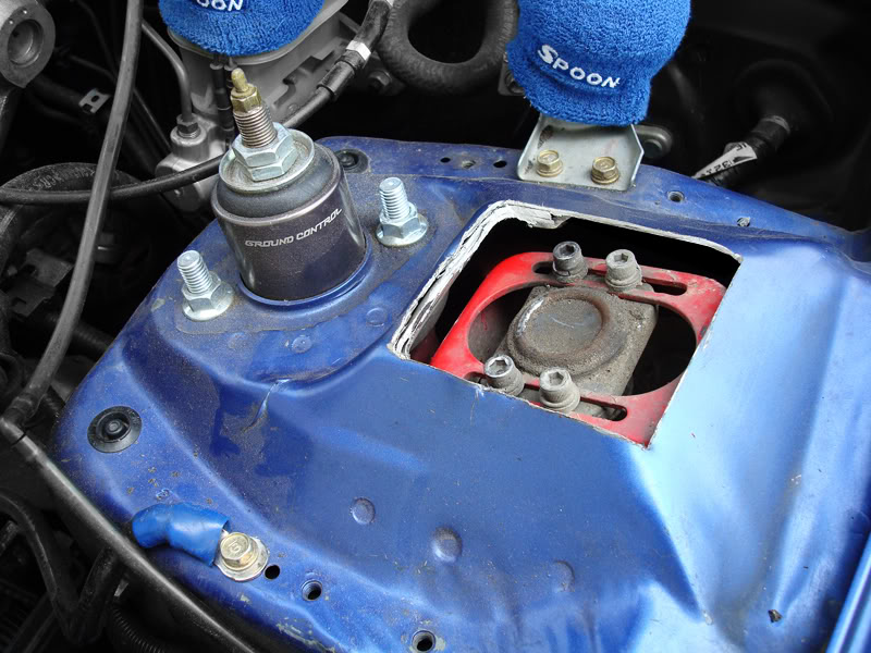

and on a side note... if ya slam the civic quite a bit in the front then i would recomend not to get upper adjustable Aarms. since the adjustable ones are alot thicker and alot more prone to bottoming out on the upper strut towers. i like this guys problem pictures.... its defiantly changed my mind about reusing my skunk arms.
he went a bit extreme and just cut them out to clear on this and go lower.
now hes got his stock a arms on and has the car sitting even lower...
i love it that low.... not his chop job.LOL but i have seen some nice caps welded in... thats what i plan to do to mine if i slam my 96 that low

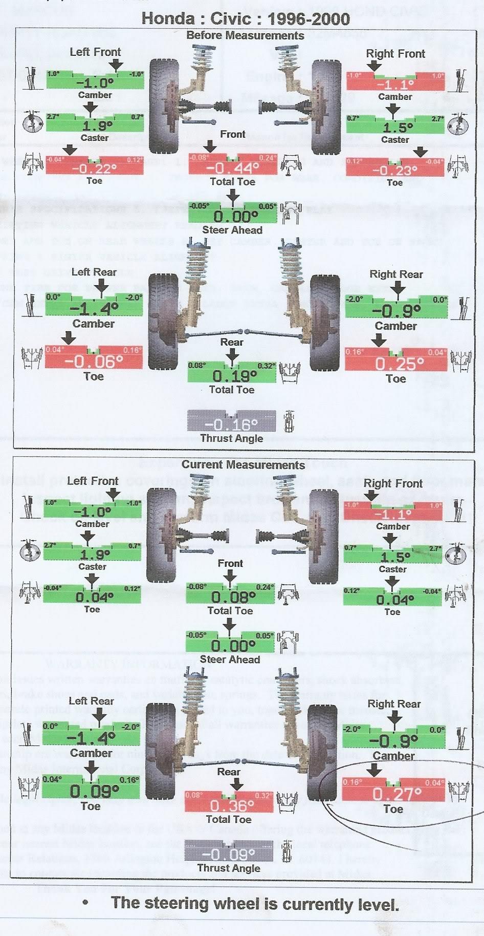

this is the spec sheet i got from my 99civic with that one seized bushing on the passenger side.
forgot to say but using a rear camber kit will work great. but with Stechs the washer trick will work just fine. but if you go lower than stechs then id definatly get some rear camber arms. i dont know why buy the rear camber from lowering is nuts compared to the front!
