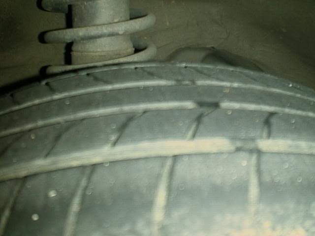

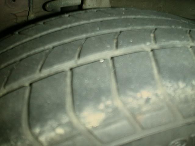

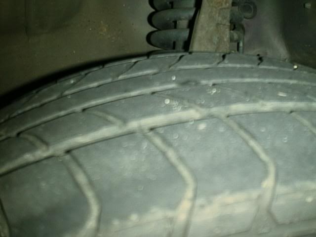

So when do you guys recommend changing tires????
Also do you think its about time that i should change my tires???? Since the tread doesn't seems to be that deep anymore plus my right rear loosing air. I'll pump it up on Sunday 35psi and by the end of the week about 10-15 psi will be in it.
Front Left

Rear Right (Bad Tire)

Front Right

wow. Yeah those are getting pretty bad. If you drive that thing in the rain too fast you're going to go sailing....literally. I have Kuhmo Ecsta tires on mine and they seem to be a pretty good all-around tire.

see the little bars in between the treads? they go all the way across, about half an inch wide? those are th ewear bars. when th etread gets to that level, they need replaced.
