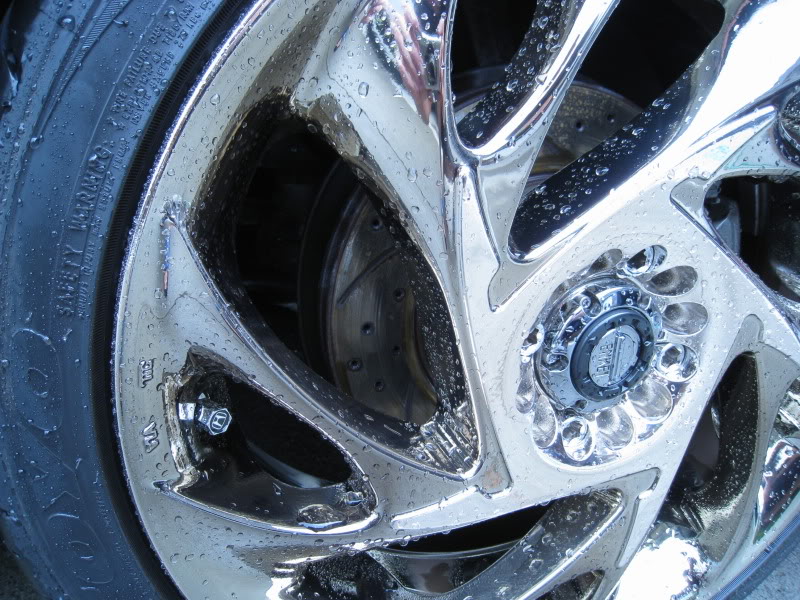

hmm I did some research and seems like the GSR rotors are the same size as what I have now. I was thinking of going with GSR setup but I don't think theres much difference then an Si setup. The rotor measurements are the same front 262mm and rear 239mm, this is what I was told. If I am wrong let me know. Cause I would definately want to go with bigger rotors. Here is a pic of my front si brakes with toucan rotors.. had these for a while now. Time for some new rotors
