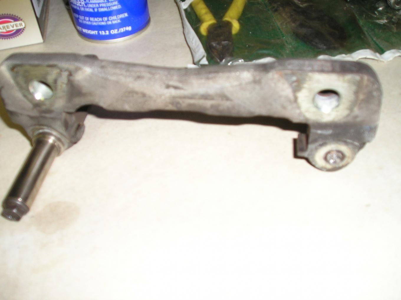

In the process of changing the brake pads on my 99 HX the bolt that holds the passenger side rotor on broke (caliper bolt according to parts manual)
. I do not have an easy out to get the old bolt out plus it is too tight for vise grips. I was able to get it off the car (metal piece that has broken bolt) and I am going to see if I can get some one to take it out. If I can't get it out does any have one that will fit my car. I can send a picture of the part if it would help.

Thanks. Broke an easy out trying to get the bolt out. Looks like its a trip to the machine shop. Advanced Auto did not have the replacement bold so I will try Pepboys or go to the dealer. Here is a picture of the part with the broken bolt. The first picture is the part with the broken bolt and the second picture is just the caliper assembly. I can try and get a picture tomorrow with the broken piece in place to give you a better idea. The biggest problem is that I need to get this fixed since this is my dd.
I found a couple in the yellow pages but I have no experience dealing with any in Knoxville. Could not find one that is open on Sunday. Looks like I will be taking Monday off from work to fix the problem. Part of the problem is I do not know which years and models would work.

Thanks for the idea about Pullapart. I did call them and I found that they had no civics in my year but like you said maybe the others will have the same part. Thanks I think I will give them a try. I still have to figure out how to get the broken bolt out. A guy at Advance Auto recommended a machine shop so I guess that is where I will be going first thing in the morning.
It would be nice to know if the pre-96 civics have the same brake setup so I don't waste my time.

well if its around your area just take your busted part with you and compare them. there is a high posibility that the brackets are the same. but still its cheaper to go check em out than a machine shop will charge and then you still have to go buy a new bolt for it!
even if the 92-95 brackets arent the same that bolt probably is the same and you can snag it up. hell pull the part off the car and remove the bolt and just pocket it or slap it in your toolbox. even if they do look in your toolbox they are not going to charge you for a single bolt. i pocket stuff just about every time i go to my junk yards! i got 2 cheap junk yards in my area, pullapart which already gets 1buck just for me walking in the door, and second place i go is picapart which charges 2bucks to get in the door. so im just getting my admision money back anyways!

Well, I found a junkyard that had a Civic of the correct year (96) to get a new bracket ($10). The machine shop was going to charge me $40 to try and remove the old bold and then I was going to have to find a replacement bolt. Pull A Part was helpful in that they told me exactly which year Civic would work for my car's parts.
