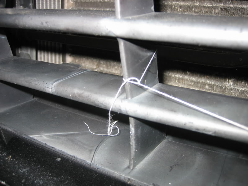

first tie string on the front of ur bumper. i tied it on the grill on my bumper.

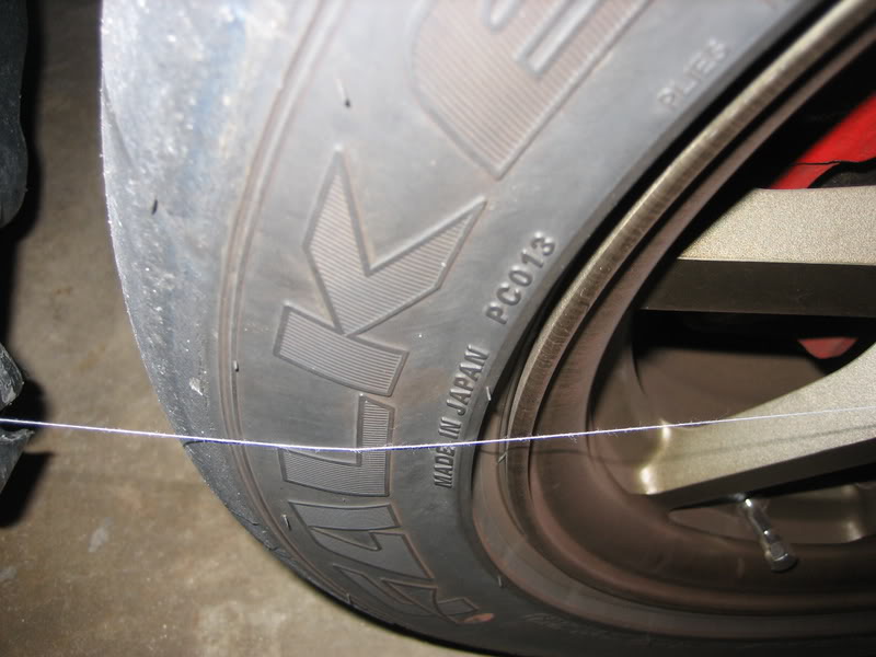

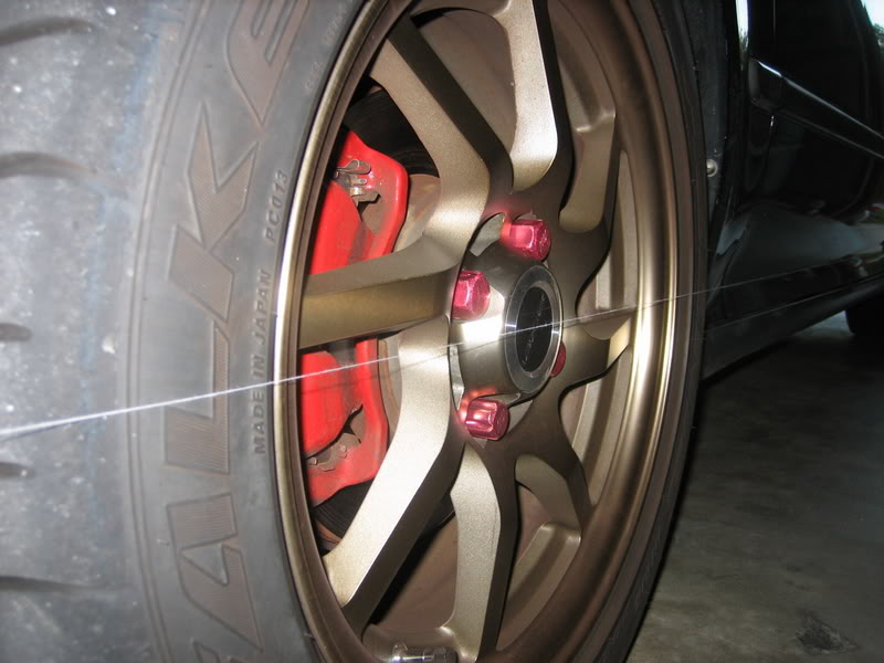

then wrap the string all the way around ur car back up to the front bumper and tie the other side of the string to ur bumper. make sure the string is touching or atleast close to touching each wheel.
line up the string to about the center of ur wheels. dosnt have to be perfect but close as u can get.

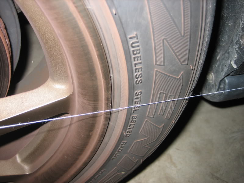

now heres how u check ur toe. look at each side of the wheel where the string might/should be touching. if the string is touching both sides of the wheel, then ur toe is correct.
heres my left front wheel. the first pic is of the left part of the wheel and u can see the string is touching it.

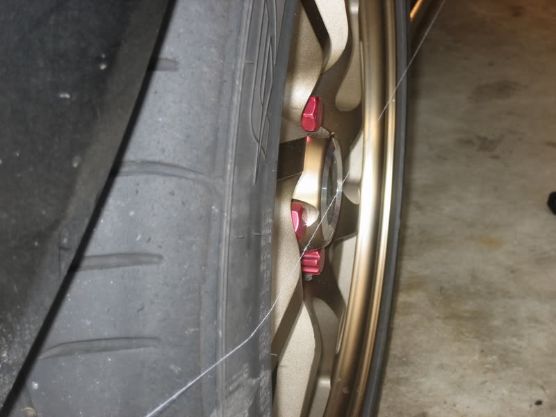

heres the same wheel but of the right part of the wheel and u can see the string touching it.

like i said, both strings are touching each side of the wheel so my toe is correct for my left front wheel. all of my other wheels seem to have correct toe, except for my right rear wheel.

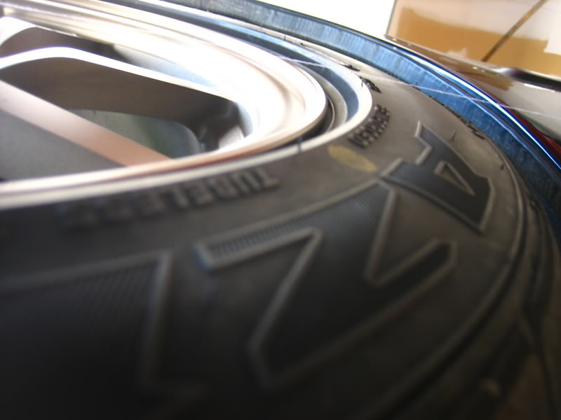

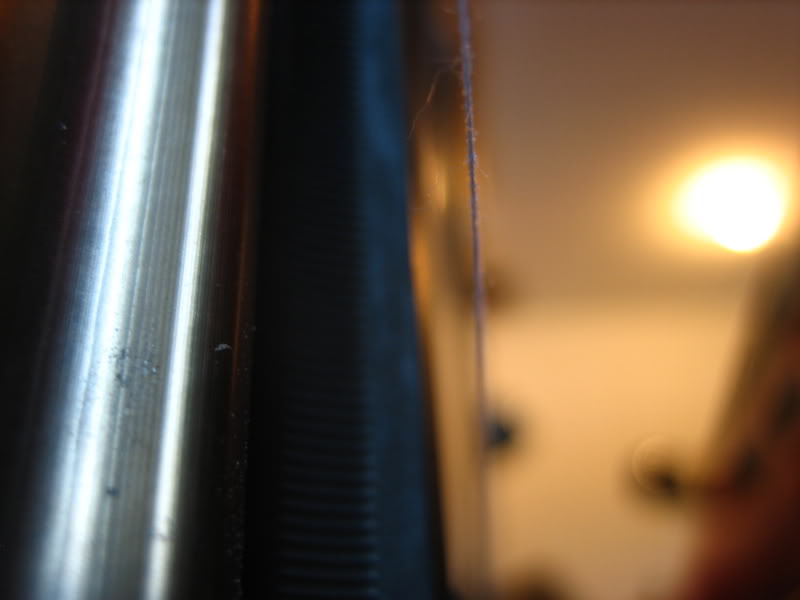

here is a pic of the right part of my right rear wheel. the string should be touching the wheel but as u can see, it is not.

here is that same wheel but the left part of it. u can see the string is touching the wheel.
since one part of the wheel is touching the string and the other is not touching it, that means my toe is off and i need it to be aligned.

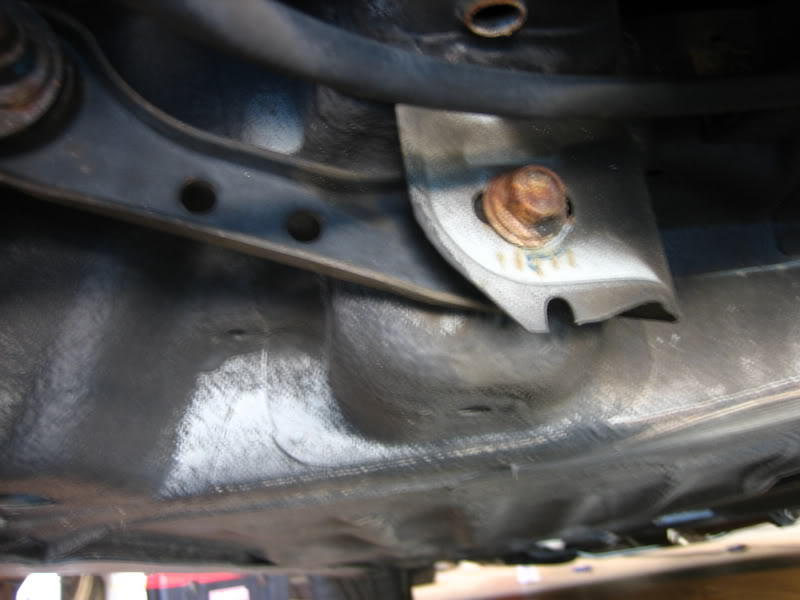

rear toe is pretty easy to adjust, it's just one bolt. you loosen it and slide the whole rear trailing arm left or right. I posted a picture here: https://www.hondacivicforum.com/m_42.../tm.htm#429268

how u adjust the rear:
jack the car up enough so the wheel isnt touching the ground. loosen the bolt that connects the compensator arm to the body(shown in pic). once loose, push the wheel in or out(depending on if u have toe it or toe out). tighten the bolt sligtly, then lower the car and check the toe with the string, if its still off, adjust again. once u see the toe is corrected with the string, tq that bolt to 47 ft lbs and ur done.
