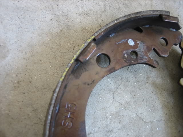

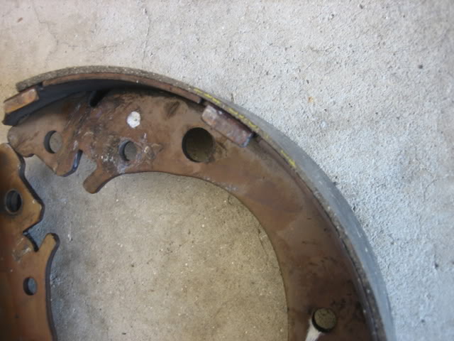

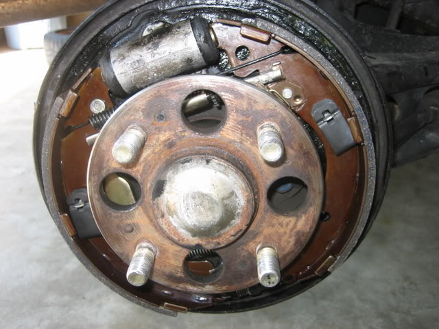

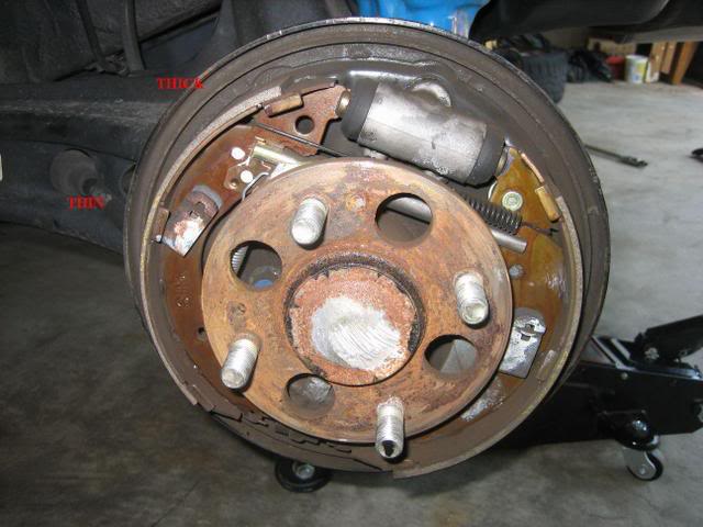

take the drum off, a few good wacks with a hammer will probably knock it off, if not thread a bolt in the 2 little holes and it'll push the drum off. examine the shoes.
if they look like these,they need to be replaced.
pics arnt that great but if u look closely, u'll notice the pad is unevenly worn. one part might be thicker than another or it might be very thin towards the middle and thicker towards the ends. this means ur drums arnt surfaced properly and needs to be replaced andalso obviously the shoes will need to be too.
ill get a couple more better pics of the shoes tomorrow now that their off the car.
as far as replacing them urself, its a pain in the a$$...esp if u decide to leave the hub on and work around it. u can see in the pics there are some springs and clips and random looking junk. all of that stuff, pain in the a$$. damn springs are strong as sh*T. its very frustratingwhen u have the piece assembled and then it springs apart time after time when trying to hook the brake cable and place the assembly on the car[:@]

If you didnt put the thin and thick on the pictures, I wouldnt of even noticed. DIY

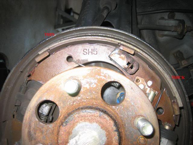

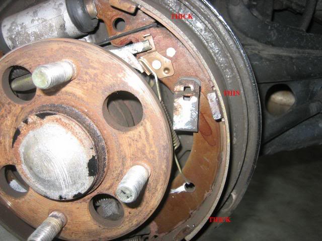

ya its hard to tell in the pics but in person its very noticable. i had one of the mechanics at my work check them out for me and we both noticed immediately after taking the drums off.
old driver side shoes

old passenger side

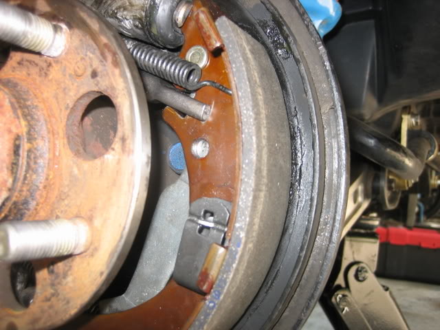

new shoes

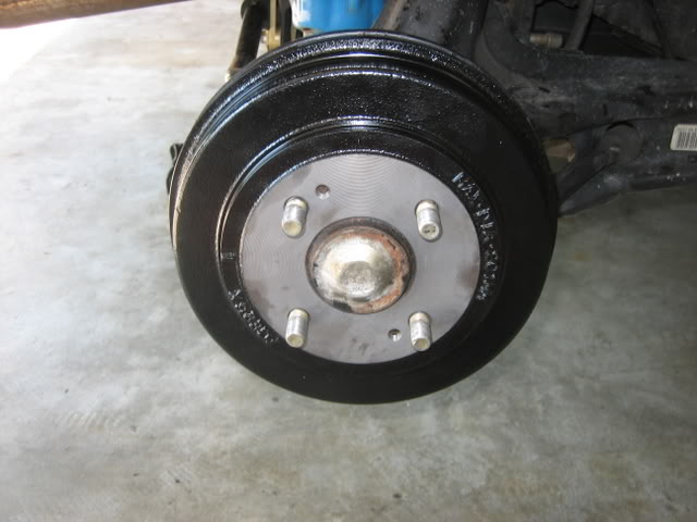

new drums
after a couple times of adjusting, braking feels alot better. stiffer brake pedal,better initial bite, andstopping distance seems to have decreased. im glad i did it,who needs rear rotors[8D]
