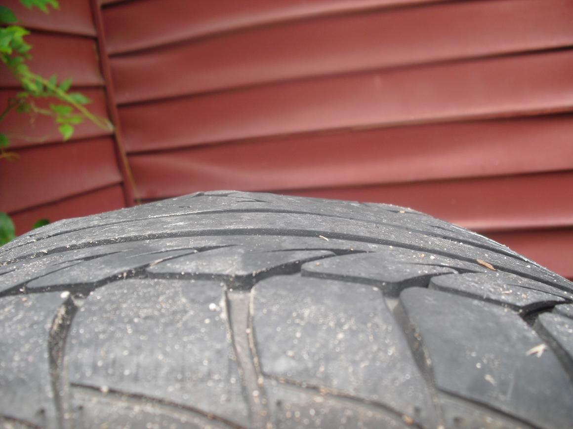

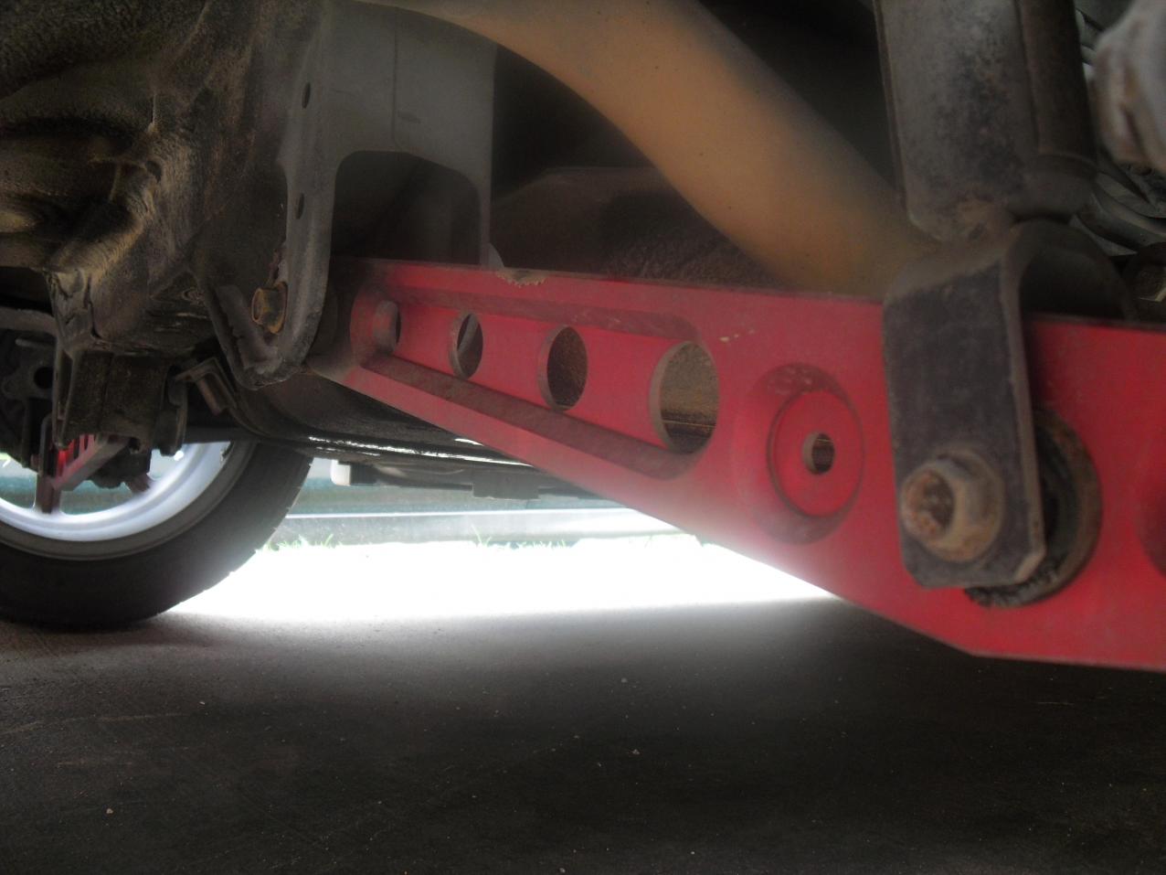

here is some pictures of it hope u can see this if not ill take another picture of my rear tire
