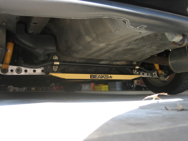

rear lower tie bar. its the gold baron the bottom of the subframe. same deal for installation as the front, take the 2 bolts out, place the tie bar up and put the bolts back in.Name:  IMG_0005-3.jpg
^that bar is the Beaks rear lower tie bar, specifically made to work with the Beaks subframe brace kit. some rear swaybar kits may not allow for the use of certain tie bars, others will work fine with most tie bars. do ur research on the products, not very hard to figure out what'll work and what wont.

Is that an Eibach Rear sway bar?
Old Feb 19, 2008 | 08:35 AM
civicexracer's Avatar
Posts: 5,802
Default RE: Lower Strut Tie Bars
its a JDM ITR 22mm swaybar
