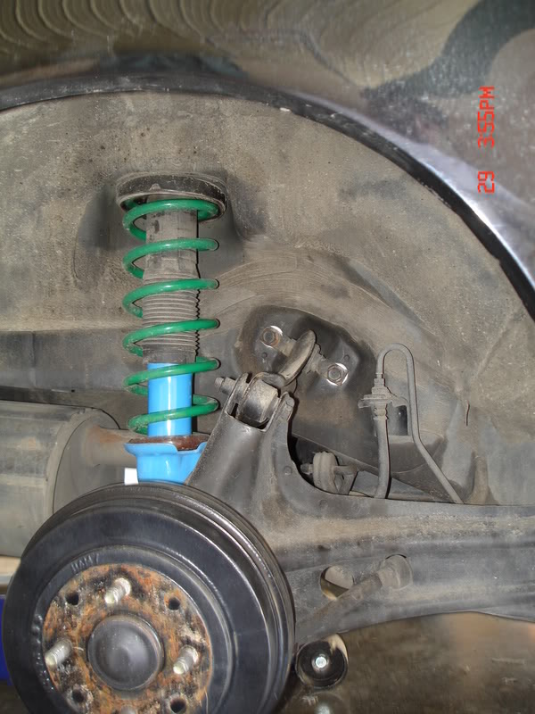

BUT TO AVOID AS MANY AS POSIBLE...... only take out the strut LCA bolt!!!! then take the two upper control arm bolts out and with the strut unbolted top and botom in the rear STEP ON THE BRAKE DRUMS TO LOWER THEM ENOUGH TO THEN SQUIZE THE STRUT ASSEMBLY OUTTA PLACE!!!!!!
WAY EASIER than messing with one more of those infamous LCA bolts if you dont have to!!!!
i had two seized up on my passenger side that made me REALY PISSED OFF so i soaked them down and thought id wait over night and pray they would bust loose.... WELL while i couldnt do anything else i desided to go ahead and do the washer trick... unbolted that piece and noticed the spindle assemble drops.... so i steped on it and then tested if i could get the strut out... which i did
now if you got a friend to help pull it out or step on the brakes..... please ask them for 5seconds of help.LOL cause doing this yourself can be alittle tricky.LOL but i did it by myself just alittle harder balancing on one foot while puting pressure on the brake drum and one hand on the car to help balance while the other hand trying to remove the strut assembly. LMFAO
id rather do it this way than messing with those LCA bolts... then you just need to buy 2 new ones... one for each side for strut... jsut cause when removing mine they seemed to strip some of the threads down in half and i didnt wanna risk that with half threaded bolts! and didnt want them to mess up my new struts nuts!
you can see the two shiny washers from that upper control arm or what ever its called in the rear.
with my Stechs and blue HPs i used 3washers which gave me perfect camber... BUT one of my TOE adjusters is still froze up so i still got my back passenger wheel toed in alittle. as soon as my fender rolling tool sells im gonna either buy the new adjustable links for them or just buy new oem arm and torch off the old one. the stock toe adjuster is enough to make right after lowering. but i might just buy the adjustable ones JUST INCASE it seizes up again....
