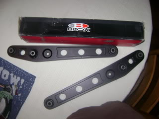

I'm rockin blox lca's I have had them in for about 2 months now. Got them off of ebay for $105 shipped (brand new)

iight. so get them with poly bushing. got it. but the pictures you are showing me dont match up with what i saw under my car on the piece that my girls father was telling me to change. the piece looks like this...
