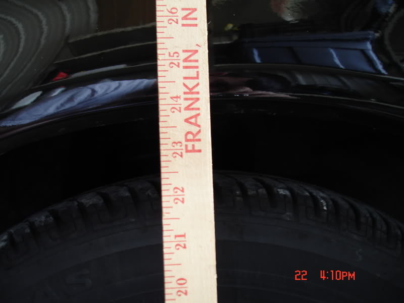

well heres my STOCK height pics.

looks to me like most are 24inches from highest part in fender arch..... tho mine wasnt and ISNT quite level still but its nothing noticably different. id inspect both sides of the rear and look at that top arm and see if thiers washers on the GOOD side... and see if thier are any on the BAD side.... if thier are none on the bad side.... and some on the good side.... just match the good size washer count.... BUT if they BOTH have the same washer count then thiers something bent thats throwing it off which it can very well be....
only way to determine is to realy check it out.... and if they match then you coudl TRY to remove the upper arm bolts again and add afew more washers AND A LONGER BOLT.... youll have to take the stock bolt to your local hardware store and match the threads up with a 1/4-1/2inch longer bolt... and try to get the camber about right by eye... then get a new tire and take the car in for a alignment...
