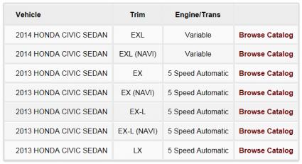

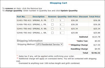

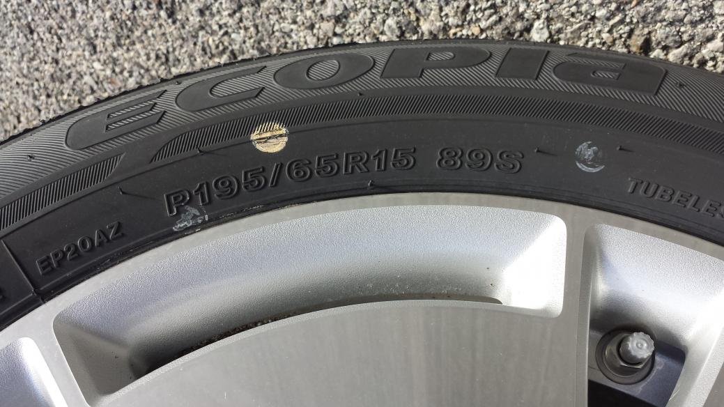

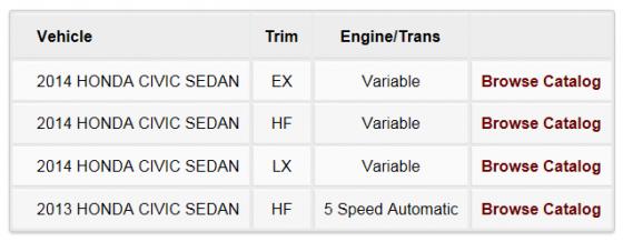

I drove a 2013 HF today and it sure does drive much nicer than the LX! It had S rated 195/65-15 Bridgestone Ecopia EP20 tires and soaks up bumps much better. I assume it had softer springs to match the softer tires. The springs for the HF will run me $146 with shipping and handling. The rear springs are easy since they are not coilovers but will need spring compressor for the front. Going to wait little bit until it warms up a little before I swap them out.
It is interesting to note that 2013 LX and EX had the same front springs but not the HF. The HF front springs used in 2013 are now the same for 2014 LX and EX! Too stiff for LX and EX? According to the online catalog at College Hills Honda, in 2012, the HF, LX and the EX had the same front springs.
