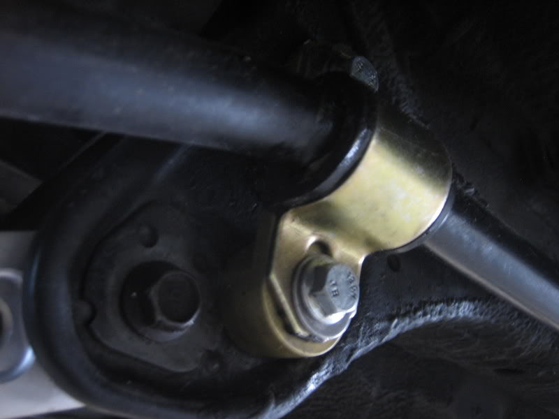

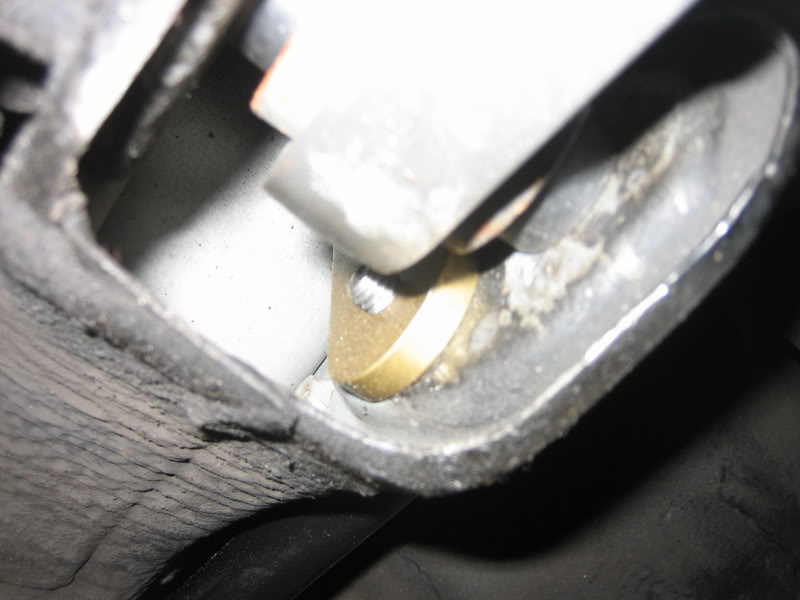

no the ASR kit is not used by itself for better handling. its main purpose is to prevent subframe tearout when using a large rear sway bar.
the actual parts that prevent tearout look similar to this. this is the Beaks subframe kit on my car, they are the gold plates that sandwich the subframe.

the ASR kit has very similar pieces that sandwich the subframe and those are what prevent tearout. that whole plate that has "ASR" written on it is mainly just bling lol.
