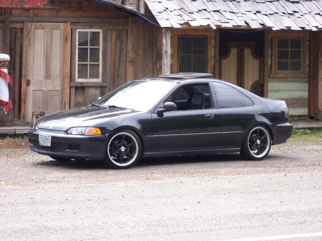

Offset is +40mm so you're fine look here
And for reference...here's my 94 with tein s-techs, no camber kits (in this pic), and 17's with 42mm offset and 205/40/17 tires
