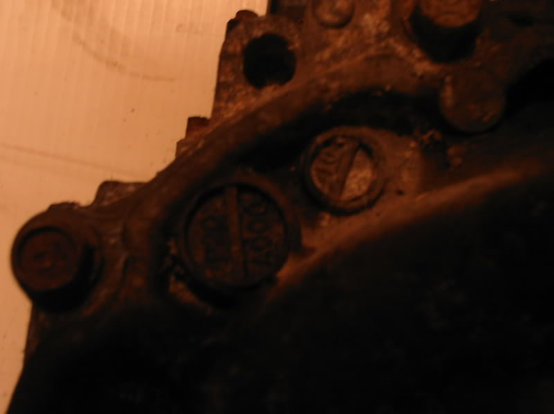

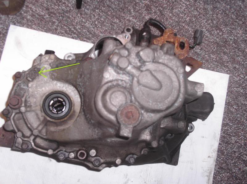

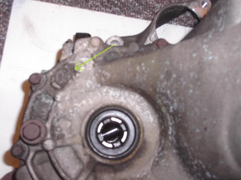

where will it say the b000 on it thx
Old Apr 17, 2007 | 07:25 PM
danomatic93's Avatar
June 2010 ROTM
Posts: 3,284
From: Milwaukee, WI
Default RE: any D-series tranny fit to mine??
look by where the tranny fluid fill is, i'll get a pic for you
Old Apr 17, 2007 | 07:36 PM
June 2010 ROTM
Posts: 3,284
From: Milwaukee, WI
Here you go:
