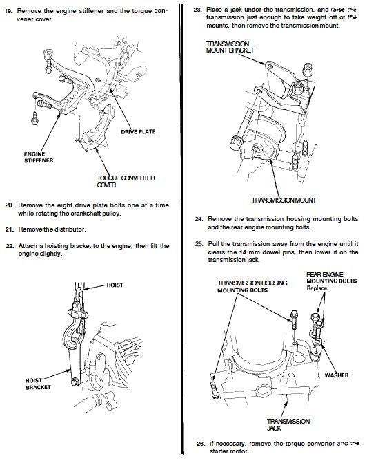

How hard is it to remove and replace a auto in a 99 DX? What's the EASIEST way to do it?
Remove engine and trans together or just the trans?

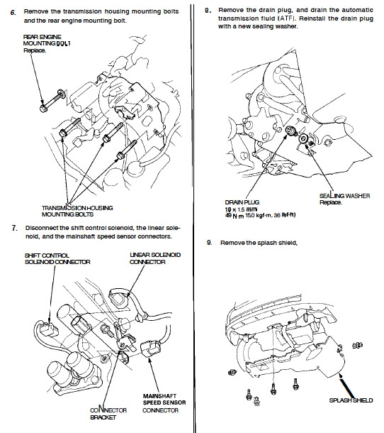

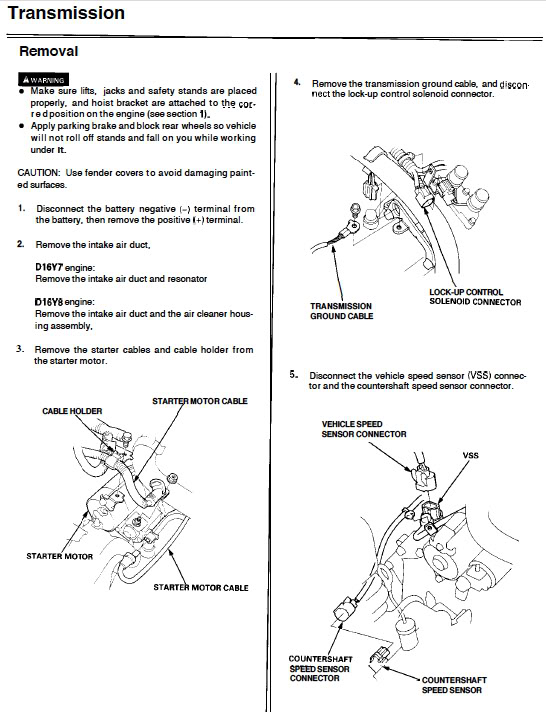

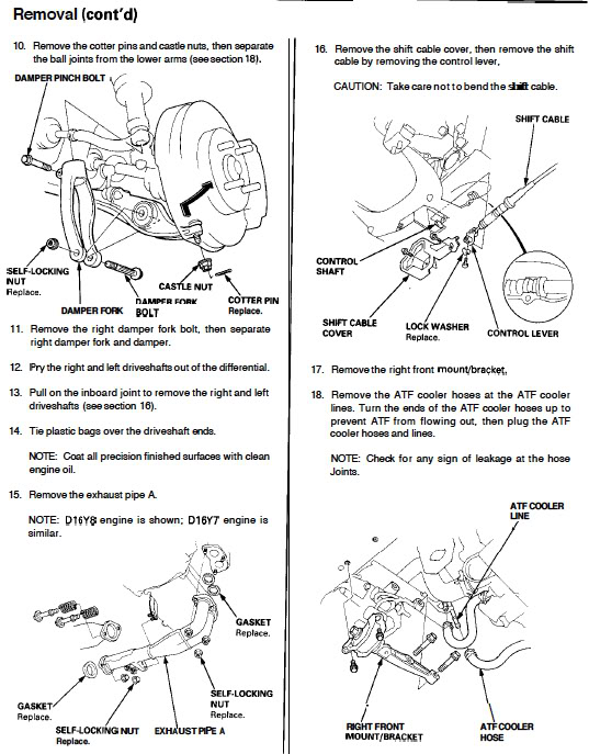

oh hell I was going to reply but Ronnie done hit it up with the diagrams

Sweet- You da Man! Thanks. I'll be diving into this SAt/Sunday.
