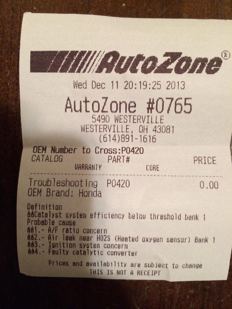

Exactly what number code is it?
1996 and later have two sensors. The first sensor (nearer the engine) is essential for proper mpg and performance. The second one (after the cat converter) is used only to confirm the operation of the cat. Thus you can ignore that unless you have to pass a smog test. (If smog tests are required, it is also sometimes a requirement that used car sellers have to get it tested and passed).
Also certain 1996 to 2000 models have a combined manifold / cat assembly which is prone to cracking near the first sensor. When that happens you can get a false sensor code (the real problem being much more expensive).

The code that Autozone gave me was P0420...Paper below
