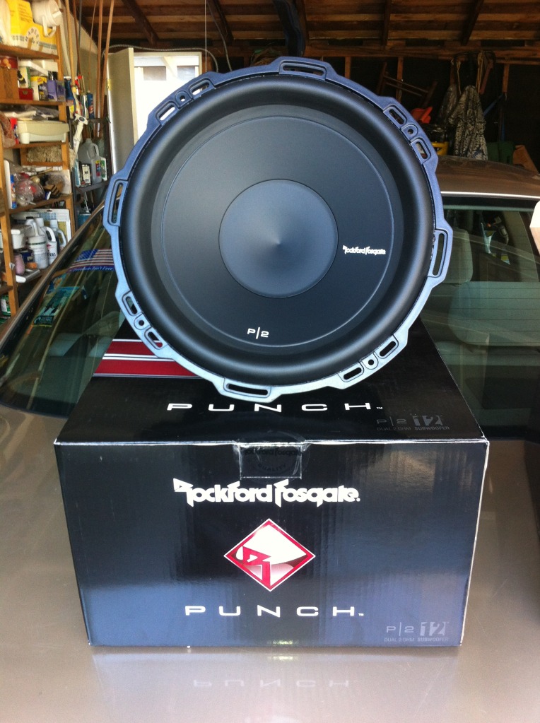

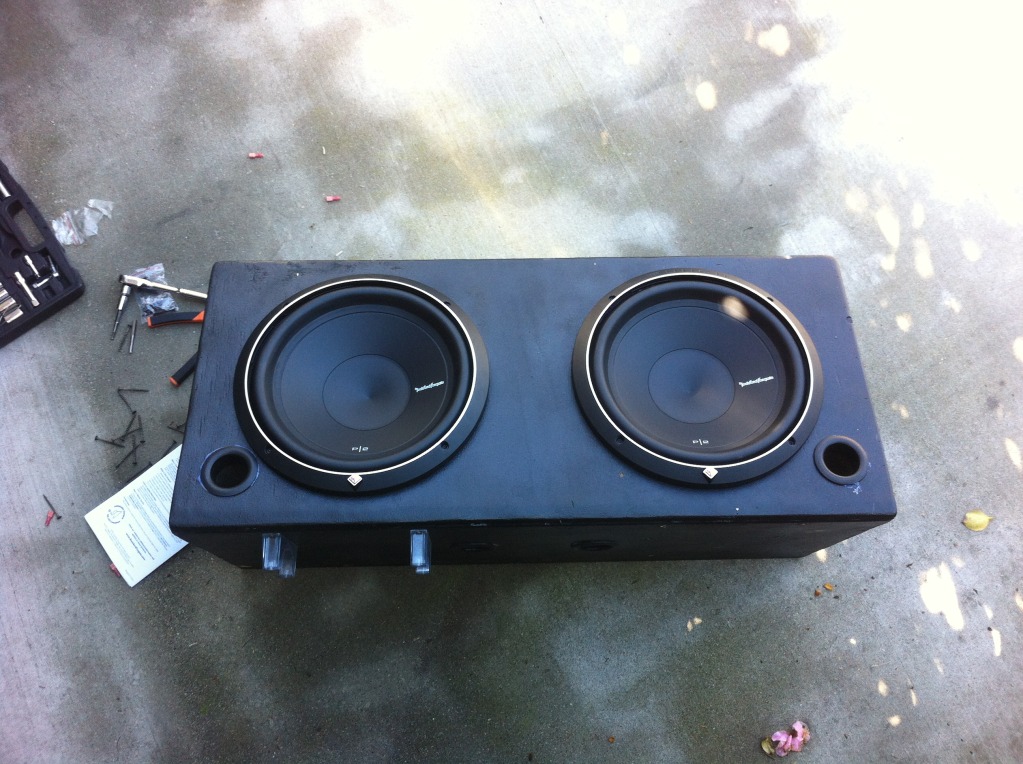

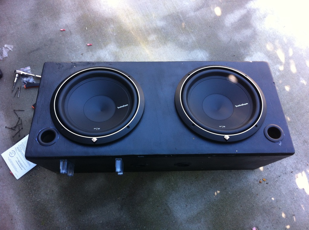

Got a new alpine f-30 4 channel amplifier and alpine type s speakers up front (already have them in back) and rewired the car like i said. it all sounds amazing now. I got a new SSD for my computer (intel330) and ditched the video card in the PC, it turns out that that was what was making the computer freeze because the mounting bracket did not fit properly so it would shake from bass/turns and freeze the PC. I dont need a video card for what i use it for in the car so its no loss.
Today i was driving around running errands and as i was leaving the store my car wouldnt start... just the starter click... i had to push start the car and get home and when i did the tranny ground was almost completely melted...
so i let everything cool off and removed the ground and it pretty much fell apart when i was massing with it. not cool because that is the same 1/0 wire that is running through the entire car. Anyway i replaced it with nice new 4 gauge cable (which is what all the other ground are anyway, maybe that had something to do with the problem?) and everything is good as new. I though the starter went bad which wouldnt be that bad but would have had me worrying about what might have caused it...(battery was fine).

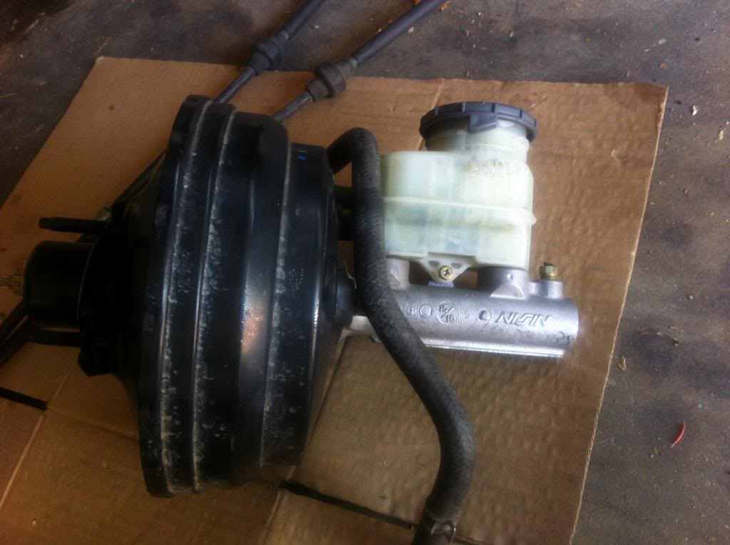

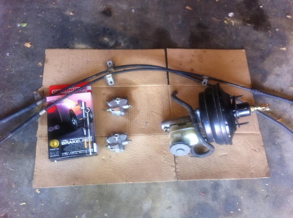

Picked up a few things today:
00 Civic Si 15/16 Master Brake Cylinder

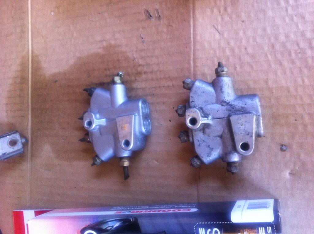

(Hopefully) 99-00 Civic Si Proportioning Valve
There is no way (apparently) to tell if the are 30/40 or 40/40 although someone told me I could take it to a dealership to find out so ill try that tomorrow!

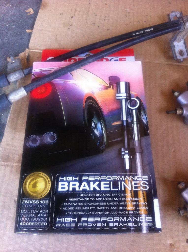

Goodridge SS Brake lines (Teflon coated)
everything:
everything:

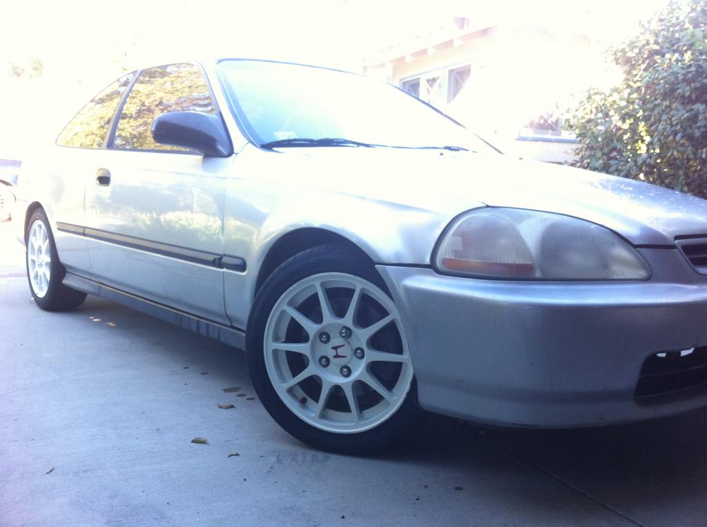

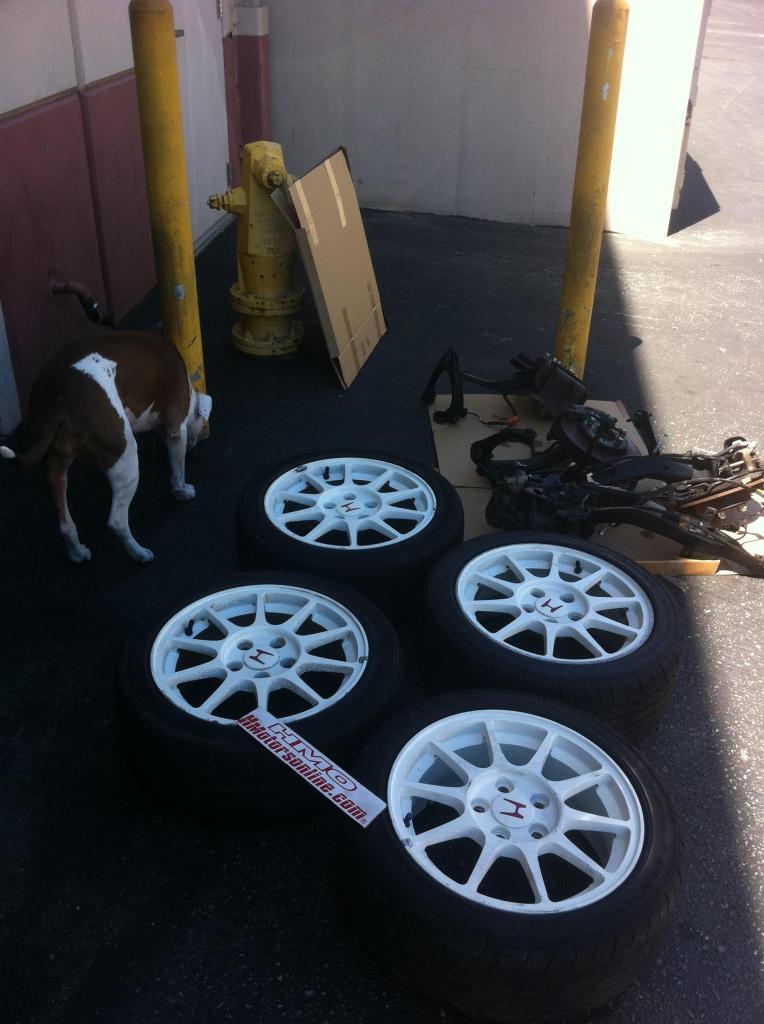

Been a long time since I posted something, been busy with school and work so stopped posting all the little things I have done. But finally got my 5 lugs swap!
CTR Stock Struts/Springs
CTR 5-lug spindles/front upper control arm, rear trailing arm

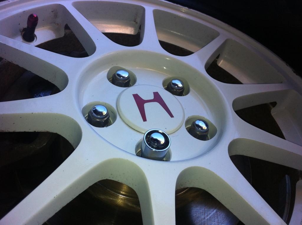

ITR 5-lug 16" rims
Took about 2 days mostly working at night to avoid the heat and I got it done. No impact gun broke my axles nuts but I had spares to throw on and got them tightened with an impact gun at a shop. Still using 13/16th MC but have a 1" ITR MC to throw in right now but lazy since I am gonna recheck everything I did in the swap at the same time (been about a week). OEM rotors/pep boys ceramic pads, goodridge ss brake lines.
Stops amazing now, even with the 13/16th MC. It actual scares me a little to realize how little stopping power i had before, also acknowledging that my tires themselves were terrible before (now have goodridge re760). No longer lowered and it is actually nice to not ruin my exhaust piping every where i go, but the suspension is still stiff (also have a flex pipe and strut bars in now).
I am very happy with this setup now. Below is a little video clip of the swap, like I said I work at night (mostly with head lamp light) so the lighting sucks.
