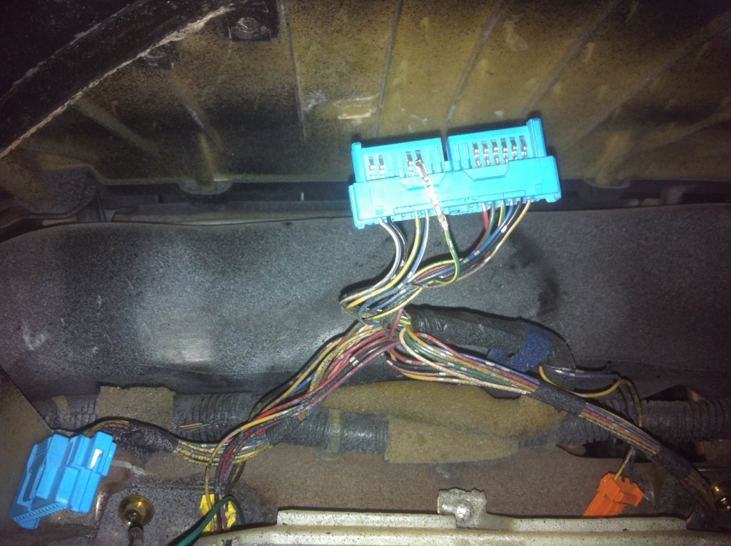

So today i was bored and grabbed a JDM IRT cluster (98 spec) from HMO (they had a sale going on so it was only $90)! Had a lot of school work (still do...) so i didnt start putting it in till it was already dark out which made everything a little easier (sarcasm). Anyway here is before swap:

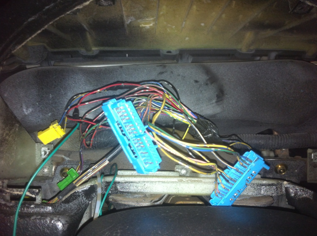

Get to those wires:
repin (not hard, just take your time):

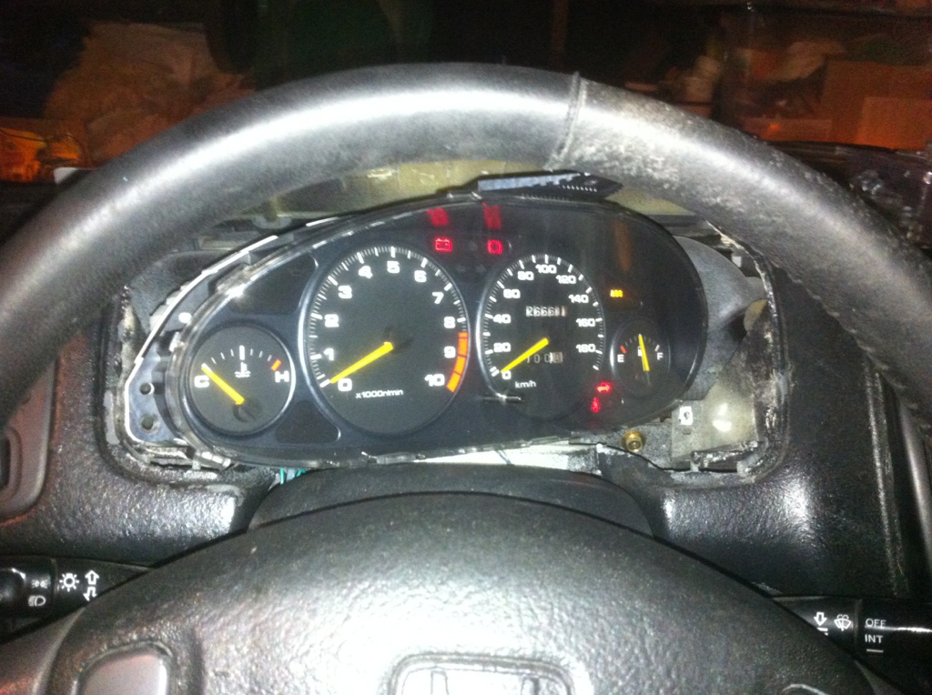

it is alive!

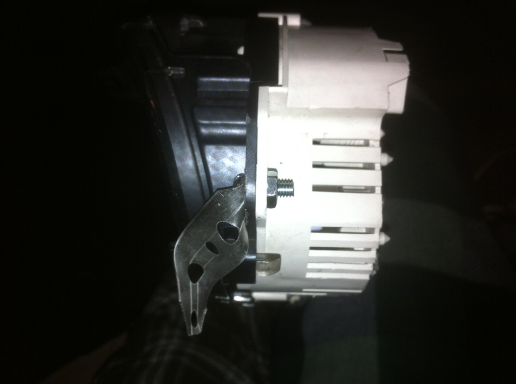

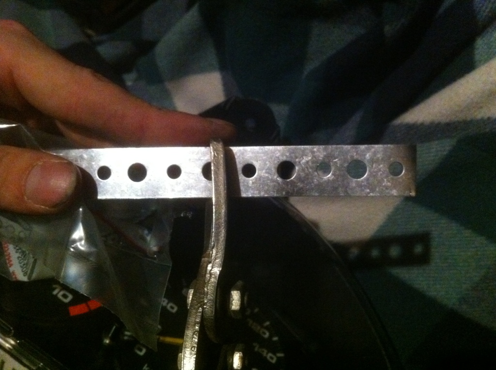

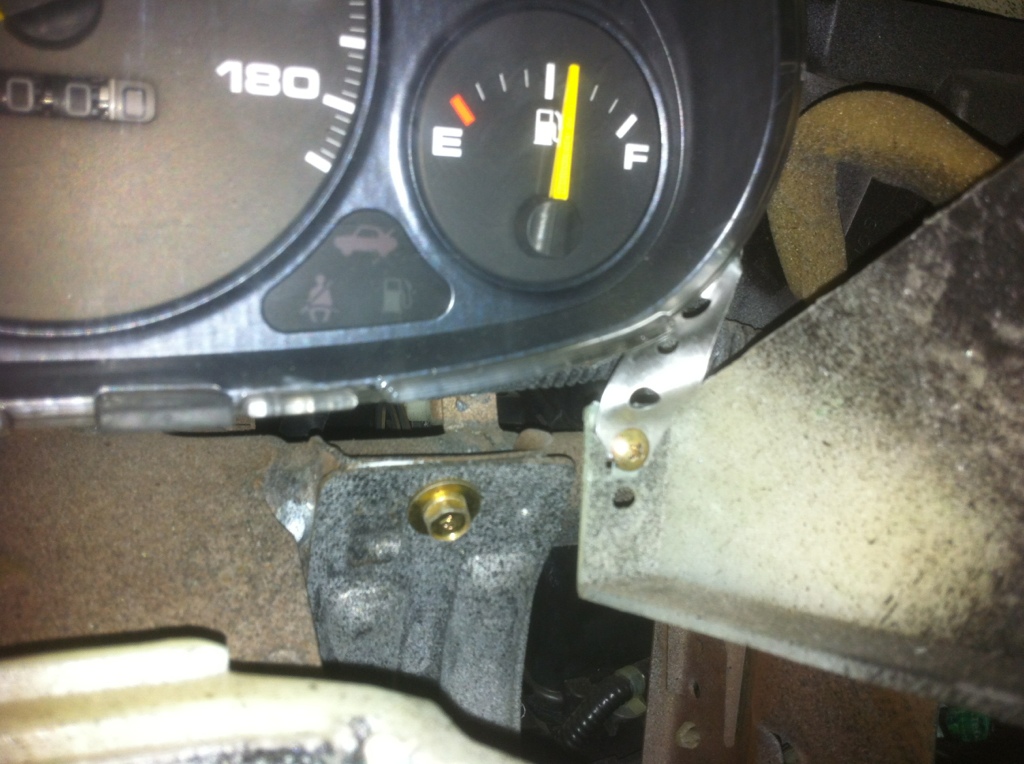

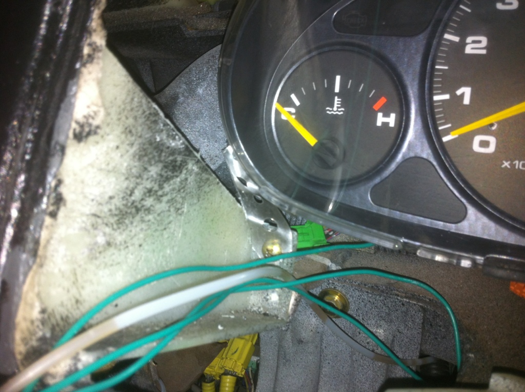

Now to mount it.... used this much for the lower corners:

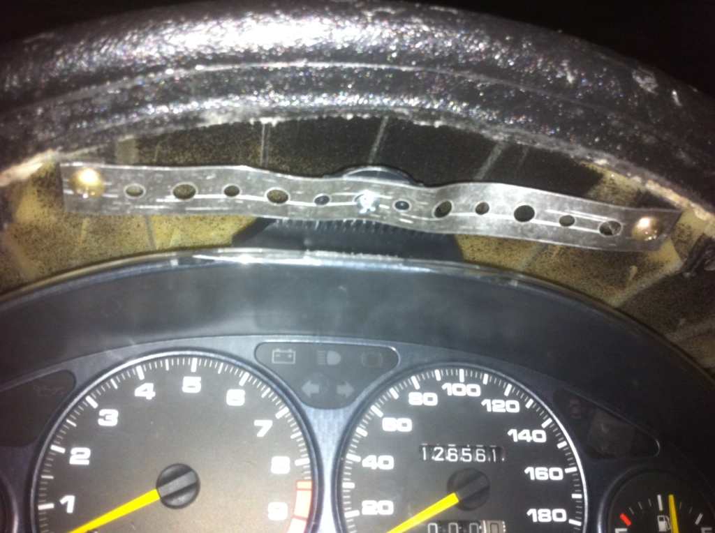

for the top i ended up only using half of this and mounting it only to the passenger side bracket since it wasnt doing that much support and was stopping the bezel from clicking in:

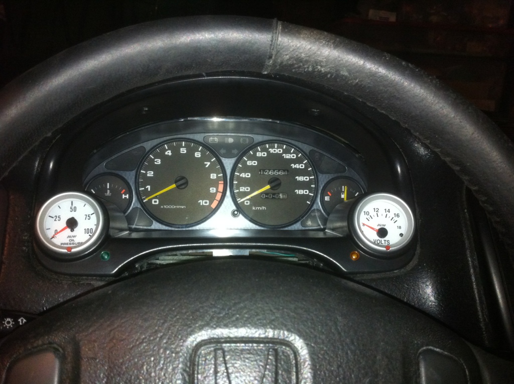

all mounted:

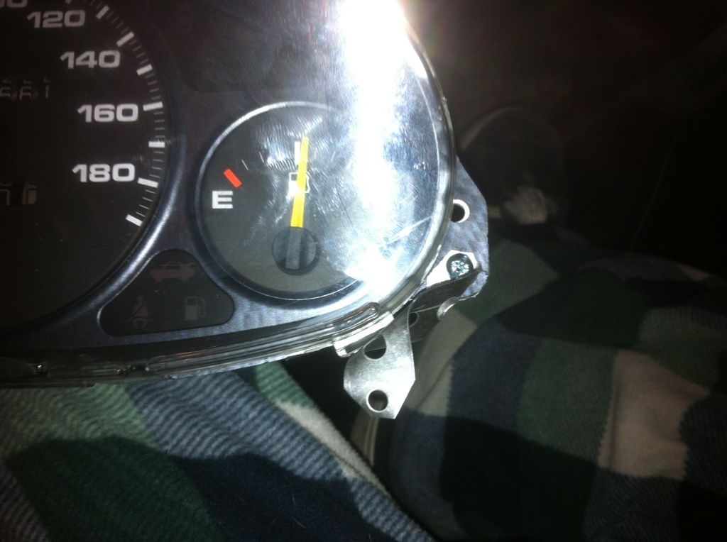

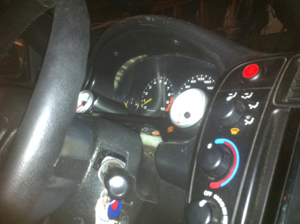

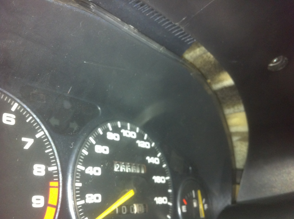

okay so i get everything in the best i could, and it all works, im happy, BUT:
my biggest problem this doing this swap was knowing the mounts didnt fit... (money in someone making a custom bracket for this? lol) but i wanted to try it anyway cause a little sloppy and $220 less than the next cheapest cluster ($1220 less than the spoon one i want) cant be beat. But why would people say there are line up issues and not take pictures of it... WHY!?!?!? well i did it and i took actual pictures of the nasty gap (that is fixable) that is left with this swap....

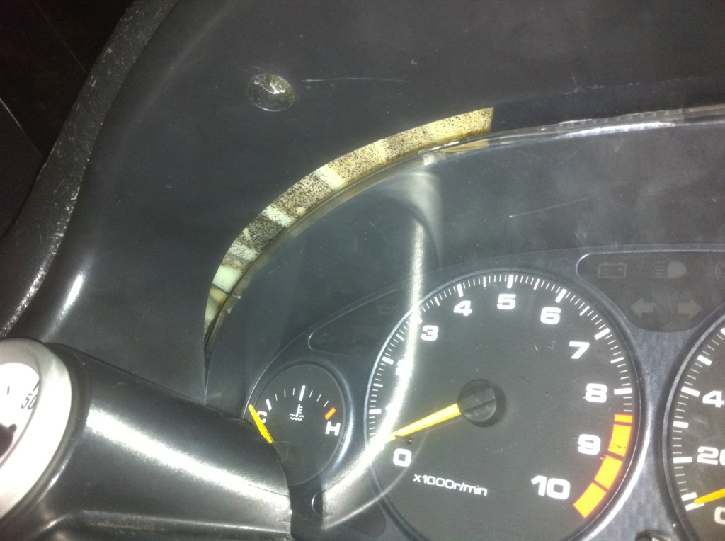

the lower gap people emphasized wasnt even bad:

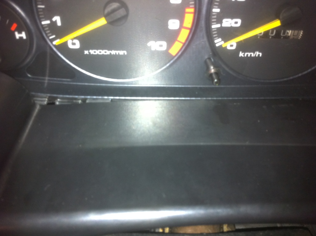

even up close.. maybe its the way i mounted it... wait till you see the top...

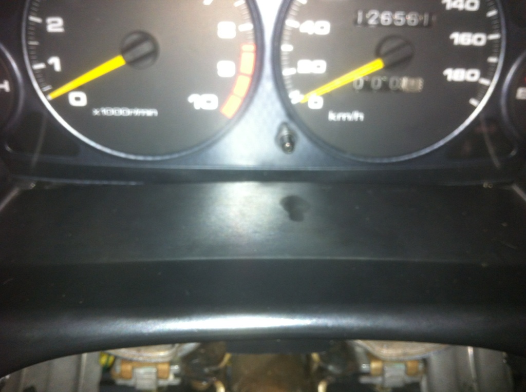

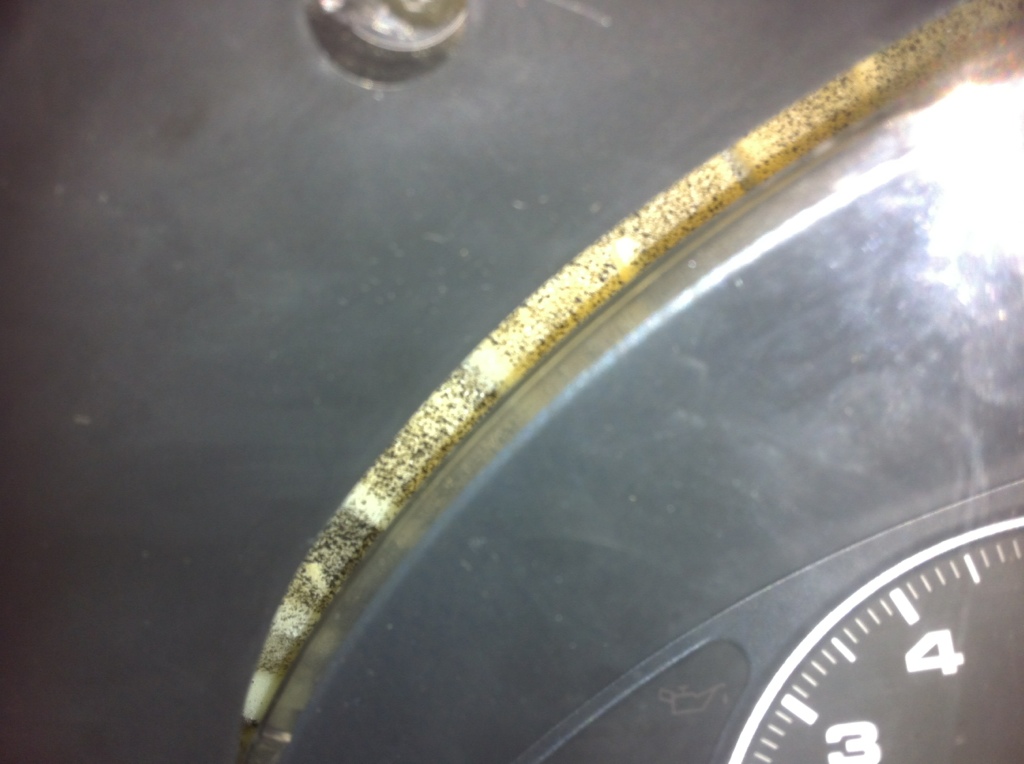

top:
from the passenger side...

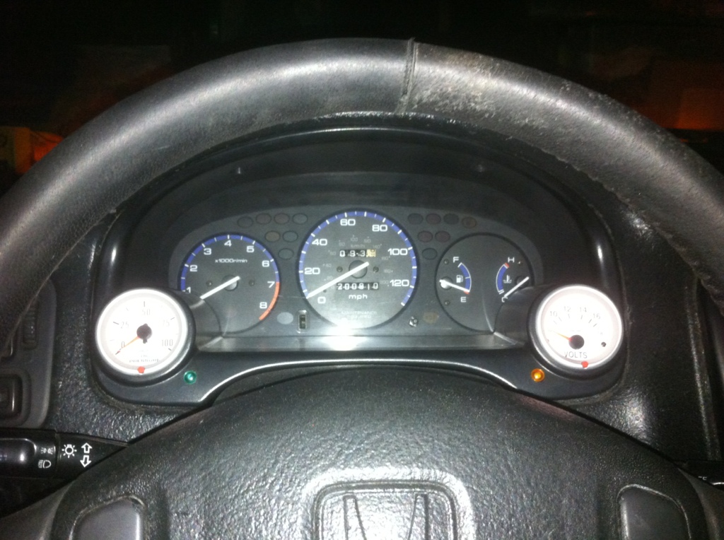

A piece of black cloth or soft rubber will make the gap disappear in no time, not that i want to open everything back up again.... but take a look at these next few pictures and youll see how bad the lighting is, its really dark... not to mention that the bulbs in this one are wired via the soft plastic circuit board making splicing the oil pressure/voltage gauges into the dash lights slightly more challenging.

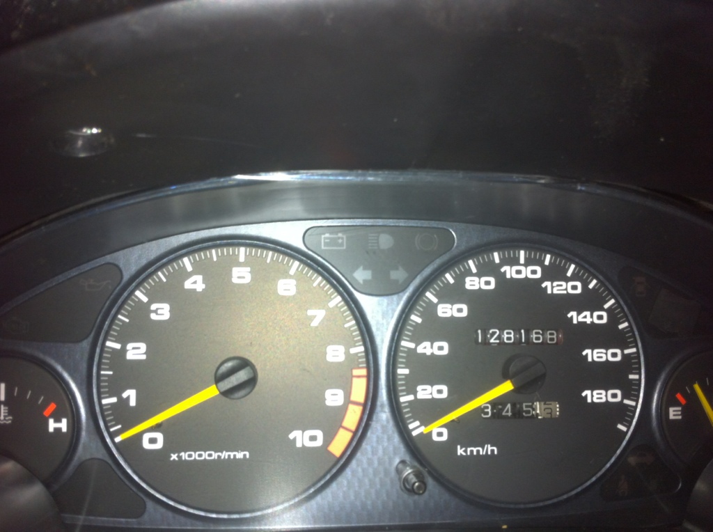

Regardless is looks way better than the EX cluster, so sick:

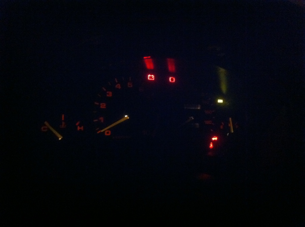

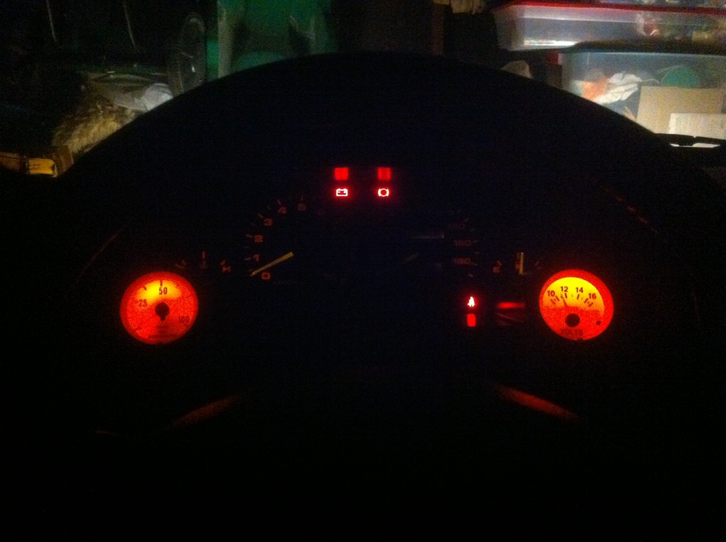

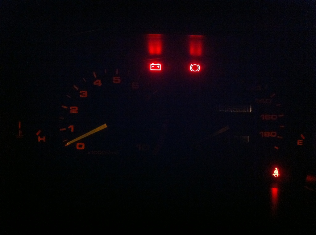

lights:
close up:
already ordered new LED red bulbs...
when i go to put those in i will also tap the voltage/oil pressure lights to the cluster wiring lights power instead of an accessory line like it is now temporarily (downside being they are always lit up when the keys are in...) and i will also be making something to cover that gap for my ocd.

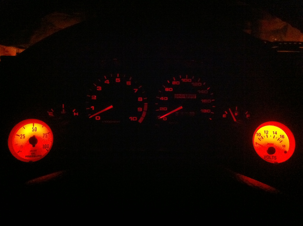

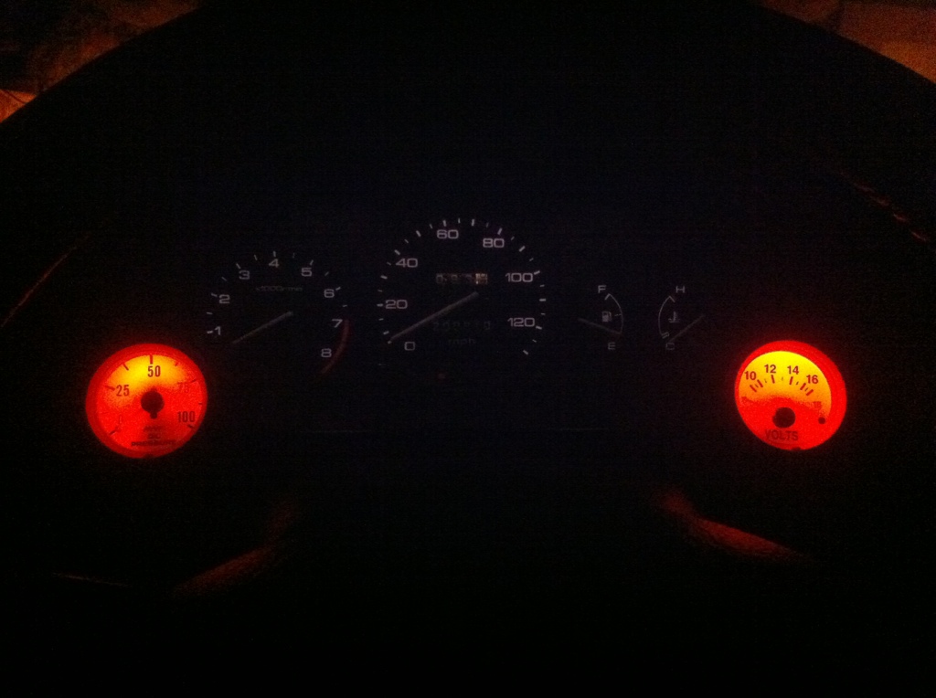

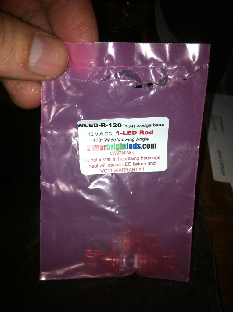

the LEDs came:
so much better, my iphone cant do justice for how nice it looks...
i was able to mount it much better this time (gap isnt noticeable enough for me to do anything more now):

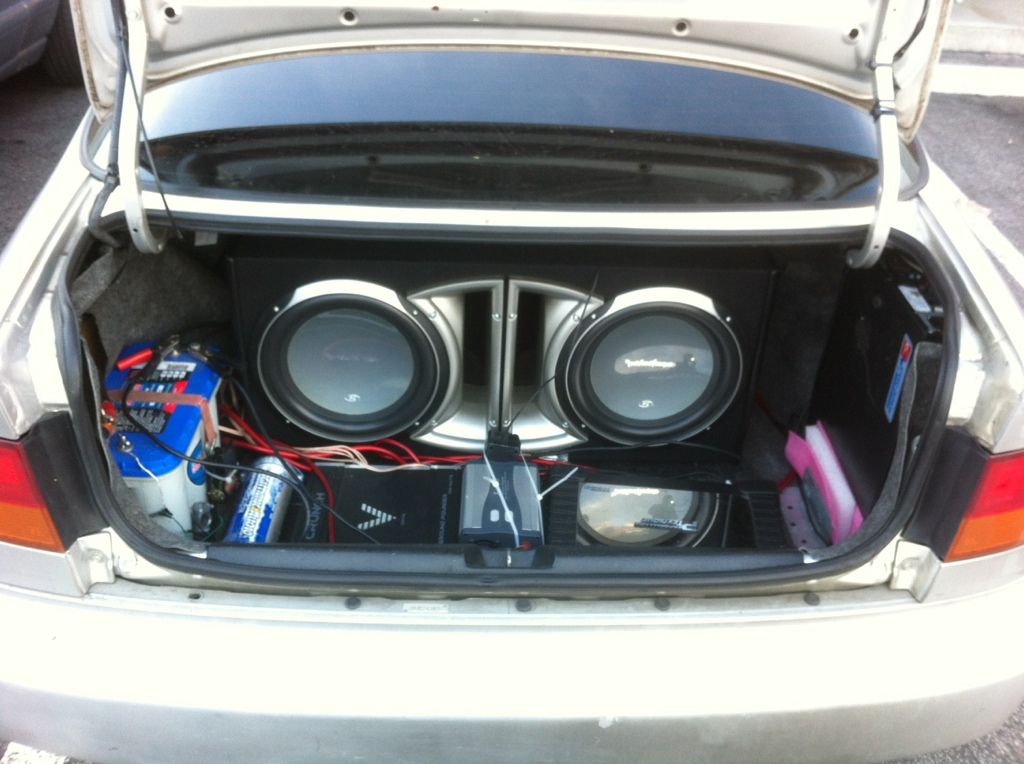

Tuesday getting the exhaust fixed up with a new cata... I drove the car to san francisco this weekend (la-fs is about 400 miles each way) and drove about 1000 miles total, made a steady 33.5 MPG the entire time driving about 80(-90) (passing) most of the time on the i5. no oil leaks or smell or any issues at all (i brought most of my tools just incase though haha). ive gotten pretty quick at converting mph-kph and via versa
also...... it was raining really bad in SF......... and i guess my weather seals are pos....... so my mother board is fried and possibly the power supply............ gonna trouble shoot a little more tomorrow and possibly get a new mother board (i have more power supplies). will also stop at dealership for new weather seal...... inside of the car also got kinda wet. . . . . i know i need to adjust the windows and grease them but the driver side isnt even a civic regulator and i dont even wanna talk about it, and both sides need new inner panels anyway so im just lazy about it. but now i need to replace all the rubber seals and window seals (ect) before more expensive(er) electronics go bad in wet weather. also looking into this it seems civics are known to leak at the tail light seals so ill replace those also... other than that im broke i cant do anything to the car anymore...
EDIT:: So only some ram went bad in my CarPC and i got it working again... none the less the leak needs to be fixed, it was dumb luck this time that everything isnt ruined. there are 2 gaskets on each tail light, inner set is 15$ a pair and outer set is 35$ a pair... ill get on it before i drive anywhere again (luckily it never rains here like it did up north)...
11/29 EDIT:::: Raining again down here and PC is done, luckily i already got a new one ready to go, just gonna wait till i get new gaskets to put the new computer in.... the weather seal gaskets....

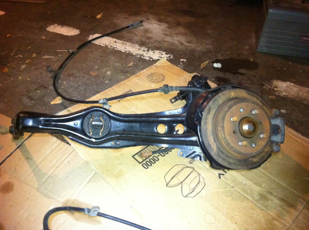

edit:: i have decided to sell the integra rear brake conversion instead of using it because i would rather just do the 5 lug swap than all this for such small brakes. PM if you might be interested in the set...
So I got a couple presents...
A little while ago the hommie hooked it up with 2 12" p2's in a special case made just for them, i was thinking about buying these and I am now 100% sure that i want them, they sound amazing. He is gonna want them when he gets a new car, whenever that might be...

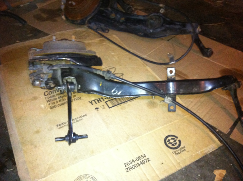

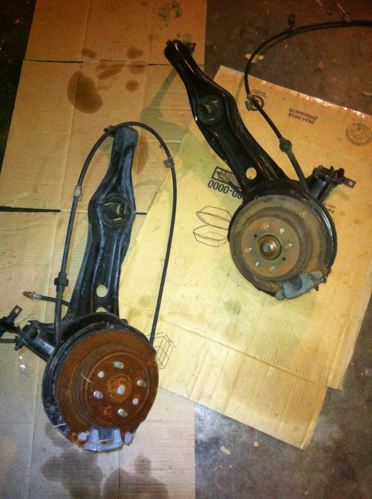

Then today i was gifted some DA rear disc brakes! i can finally swap out my non-functional rear drums... i mean they kinda work... anyway here are some pics, ill swap them in after the new year (need rotors, pads, e-brake cable):
Still gonna do the 5 lug conversion but i feel like this buys me a little bit of time on that! Should look nicer too... Also here is my friends new little pitbull puppy....
