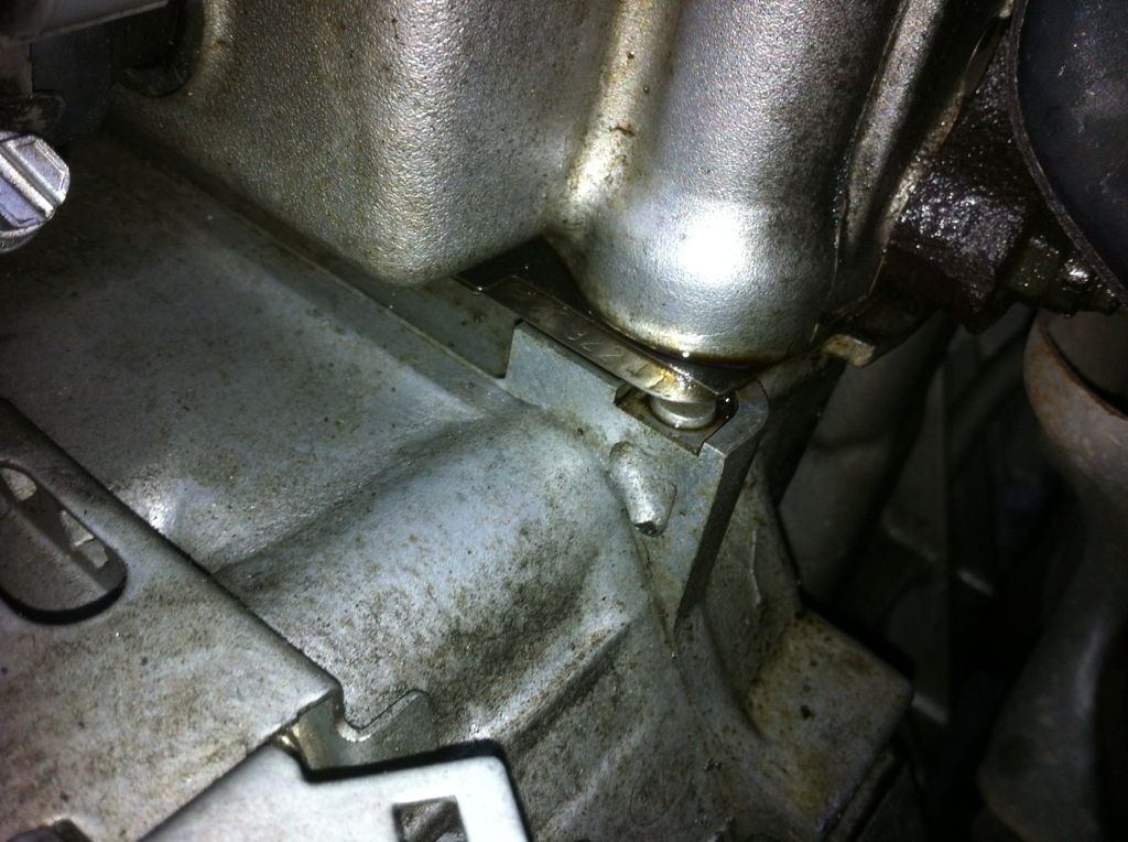

This engine had the same leak as my d16y7, well kinda... D16 had a leak from distributor o-ring and this b16b was leaking from the same area so i replaced both vtec solenoid gaskets (solenoid-engine and inner solenoid) and the distributor o-ring and also did another oil change. The gaskets and o-rings were so old and brittle, turned out the vtec solenoid-engine gasket was what was leaking. Sticking with 10w-30 honda full synthetic (made by mobil1) since its cheaper than mobil1 and the same thing. Cooling systems has zero leaks since radiator swap, so i threw away the old radiator and kept the fan, the fan is a bit bigger than my slim one so if the need ever arises i will swap that one in i guess...

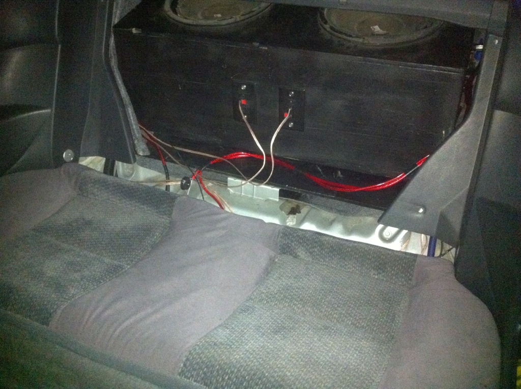

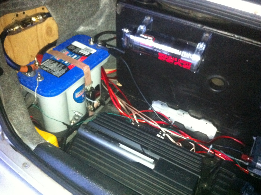

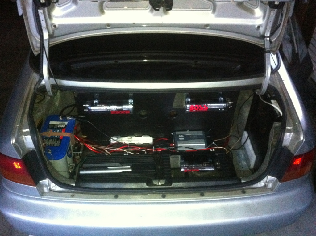

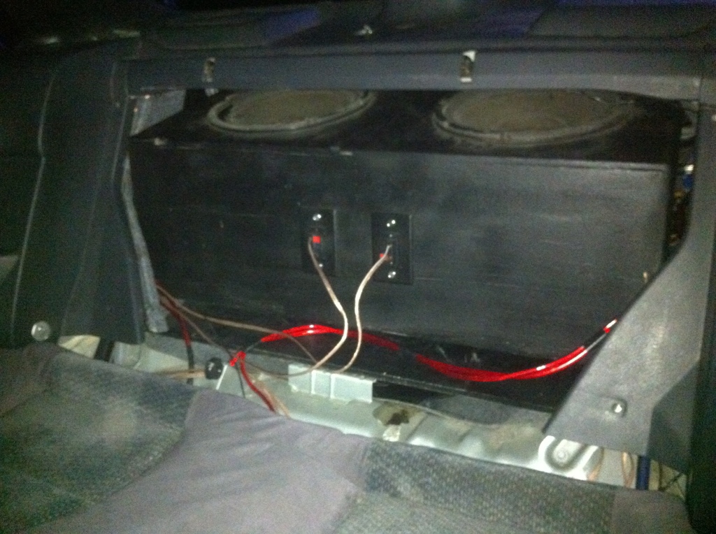

rewired all the computer/amp stuff in another attempt to get rid of the alternator whine, basically by double grounding the battery and using higher quality wire to ground the amps, havent noticed any noise yet but i will have to see what happens since it comes and goes anyway... got rid of most the case of the sony amp since it has no fan maybe that will help with it over heating and shutting down... got rid of rear seat belts, seat backs, spare tire and tools from trunk to ditch some weight and avoid driving people around easier also it sucked ever having to get back there and if i happen to get a flat tire ill figure it out then... left the bottom part of the seats for my dog ;P
No pictures because it was insanely hot while doing all this and i was dripping sweat everywhere and not even thinking about pictures but here is a picture of what it looks like now, not the cleanest but i dont really care anymore, i prefer function over form. Ill probably get some netting to seal the back from the front, loosely... Still wanna get the battery and pc where the tire used to be and then get the subs mounted on the sides with the amps kind of where they are now or further back. also looking into a dc-dc power supply for the pc. Engine has been chillin, going strong with no more coolant or oil leaks! Still waiting on that money from the tard that turned in front of me -_-
Id look into tucking the wires more but i want a total remodel anyway so i figured i shouldnt bother spending time making it all clean just yet...
Those subs might finally need replacing, getting a little raspy, ill wither re-seal the rubber lining or just get some new rockford p3 12"'s or something since they are pretty cheap and sound nice (i have old versions right now)...

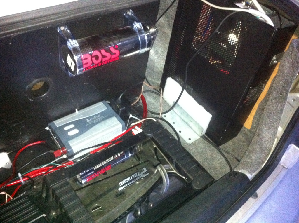

Those boss 2 farad capacitors? both popped into large chemical clouds and one caught on fire, just used them for the first time today and did everything as told to in the instructions they came with... Luckily i had some old "lightening audio" capacitor (1 farad) that works like a champ now, someone gave it to me a long time ago for fixing their pc...

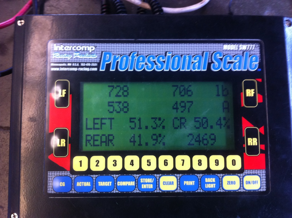

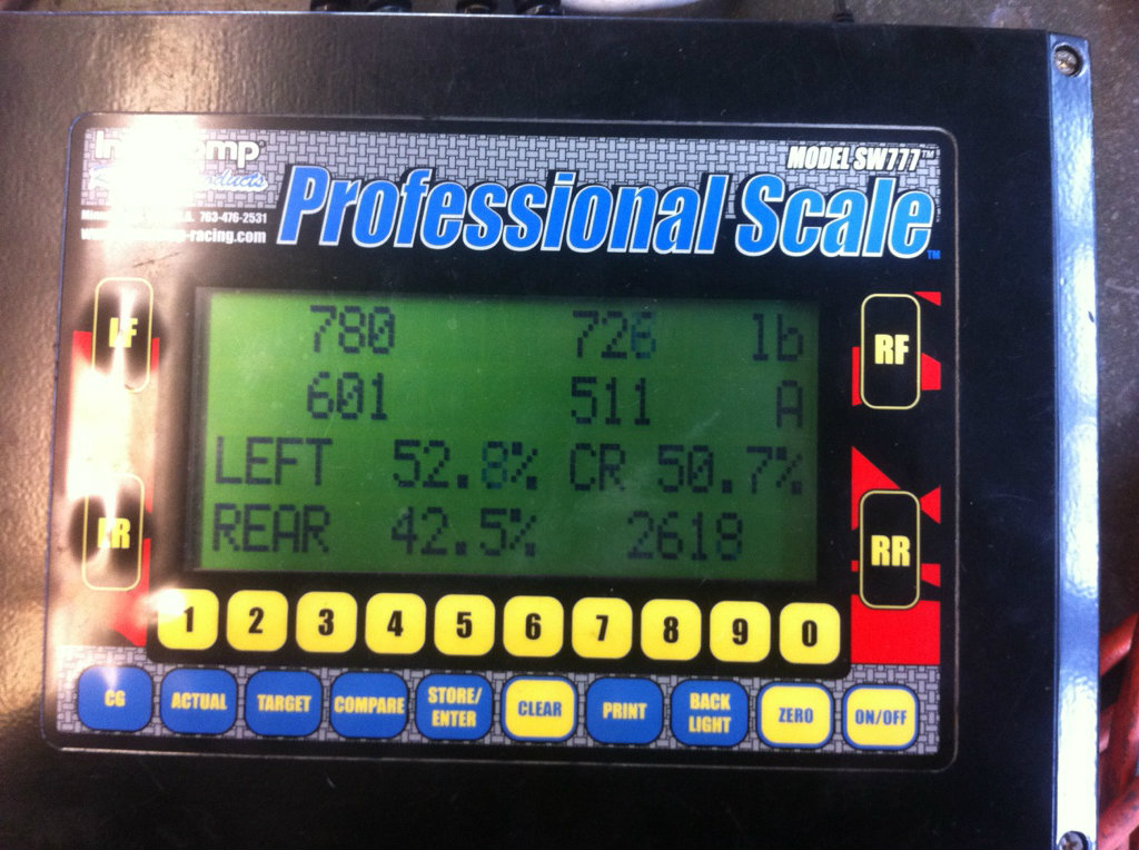

Without me in the car:
With me in the car: (im light heh)
i guess the front would have been more balanced when the battery was in the front right of the car, that cannot be helped now but maybe i could put a little weight up there or when i get a better suspension i could tune it to be slightly stiffer on driver side. the rear i will balance by centering the battery/computer then redoing the subs/amps mounting somehow. after rewiring everything and isolating all the wires ect there is no way to get rid of the alternator whine (even though it is barely noticeable now) my last options are to get a new amp, get an external sound card and getting a better inverter or even better a DC-DC inverter... I might go to a audio shop and see what kind of prices they will give me for fabricating a trunk for me since i dont have any of the tools for a job like that and the person that helped me last time (who did a great job) has moved far away and doesnt specialize in these things anyway, i want it to be light and balanced...

so did another oil change today and every time it still comes out black with only 2000 miles or less of use....... AND i lost of quart of oil this time, and the smell then it all hit me at ouce, this f***ing things head gasket seems to be leaking! ARGH!

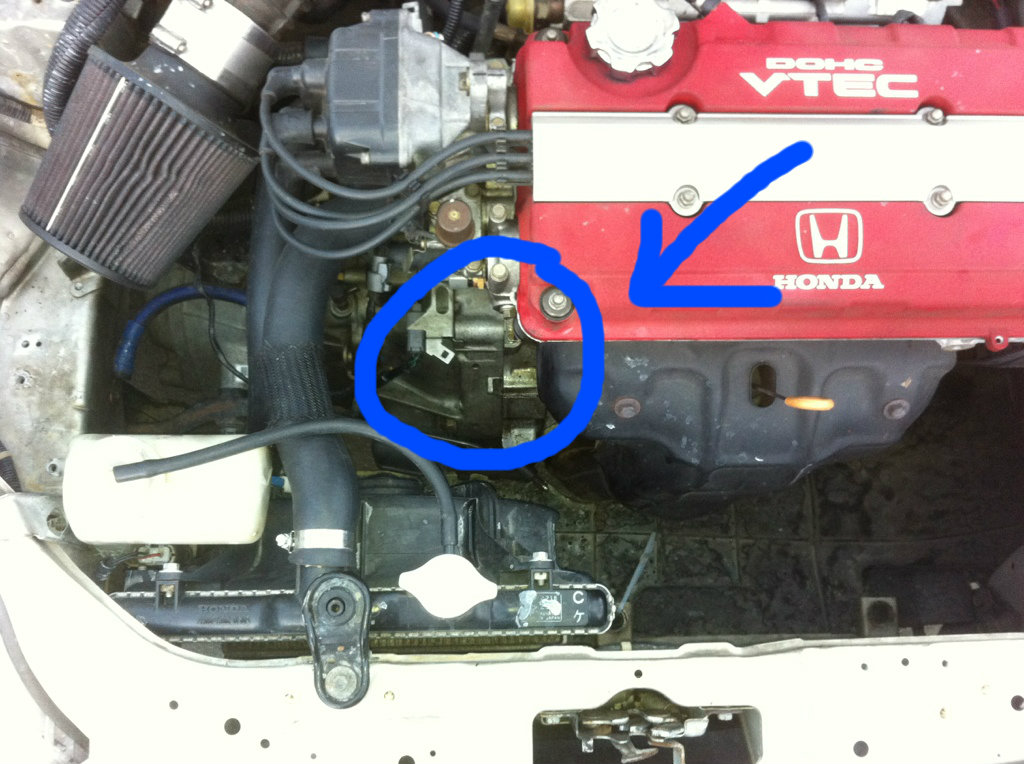

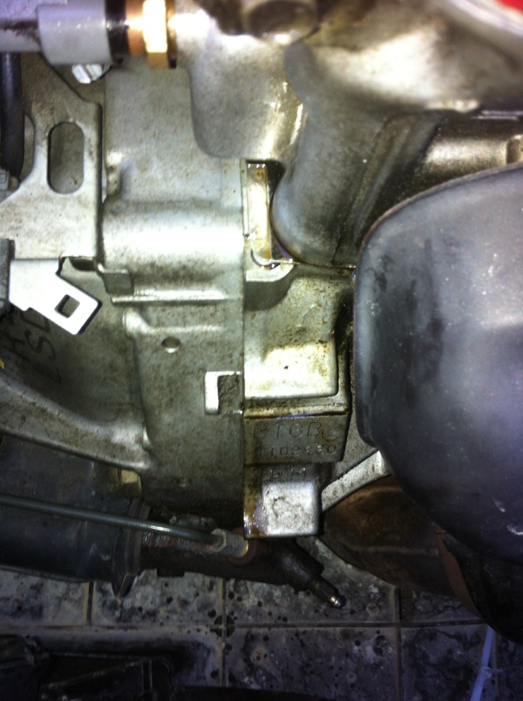

Right at that little serial number plate is there the oil is coming out, if you are facing the car its the front left corner leaking, i cleaned everything during oil change and drove 5 miles, look and there is fresh oil just coming right on out......... its the only place i can see leaking and i imagine it HAS to be the head gasket, i hate head gaskets. There has been no over heating, no coolant loss, only some white smoke from the tail sometimes but im am positive that is from running lean around 5-7k RPMs.
This sucks cause its a lot of work... But whatever. So I am gonna get some performance HG (high temp or whatever it would be) and get a valve cover seal/head and valve bolts/IM EM gaskets all at the same time, and i will clean the engine of the oil that has been leaked while in there.
Not too worried about the work, seems very straight forward and I will just rent a cherry picker to lift the head replace gasket and drop it right back down. Will also do fuel pump, fluid flush while doing this. And I will take some pictures this time! 5 lug conversion is on hold for now, will probably do it in a month or two if i want to be broke again, needs to be done though. Also looking into throwing an 8-point roll cage of this style into the car:
