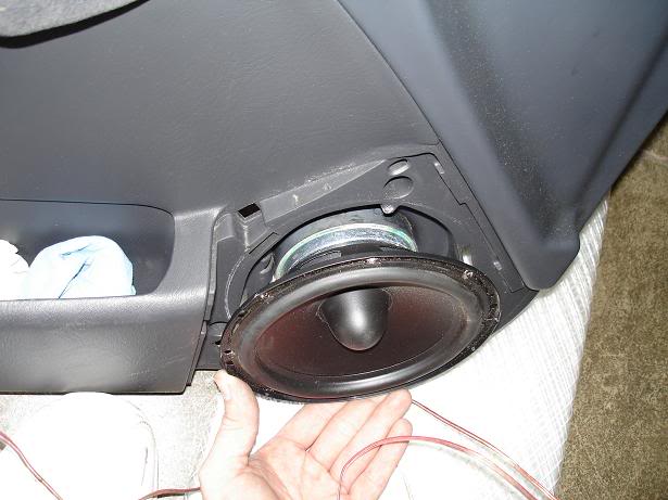

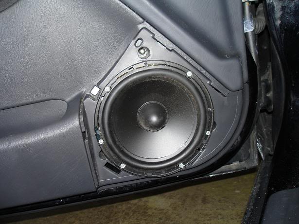

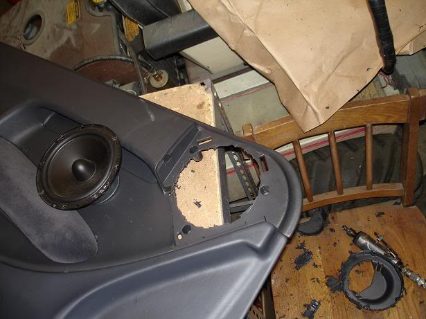

chop out the plastic around the door panel enough to fit and if you need to make a spacer or just washers between the door panel and speaker frame to space the speaker out alittle.
the stockers SUCK......
have fun choping just be sure to CUT SMALL ONCE and recut little by little.... its easier to cut a small sliver out than it is to build some kinda adaptor if ya cut to much out
heres mine.

addiction2bass Nice work!
That my friends is how you put 10lbs. of speaker into a 5lb. sack.
Again... nice work.
