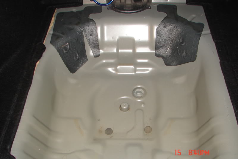

Before the dnyamat - your looking at where the spare goes or wheel well

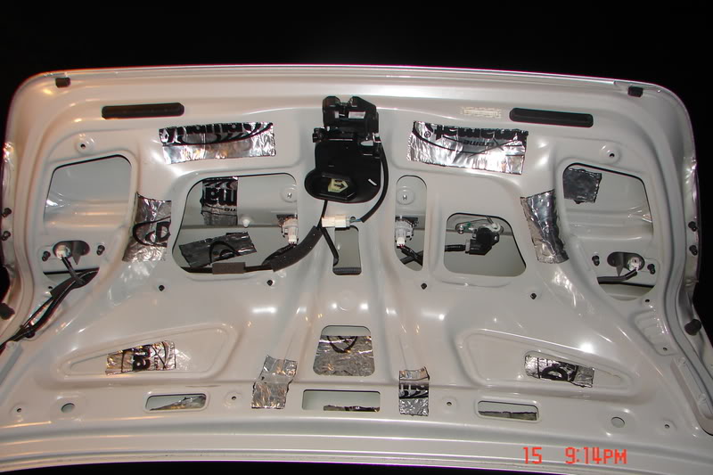

After the dynamat - your looking at where the spare goes or wheel well
Trunk Lid

The way in install dynamat or dampening for anyone who isn't going to compete at a high level, this way works for amature competition just fine, is to tap with my knuckles all over the trunk and find areas that sound either loose or hallow, and put a piece right over that area, you can save a lot of material this way, and it works really well.

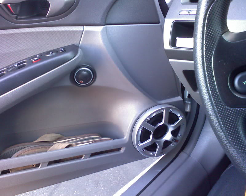

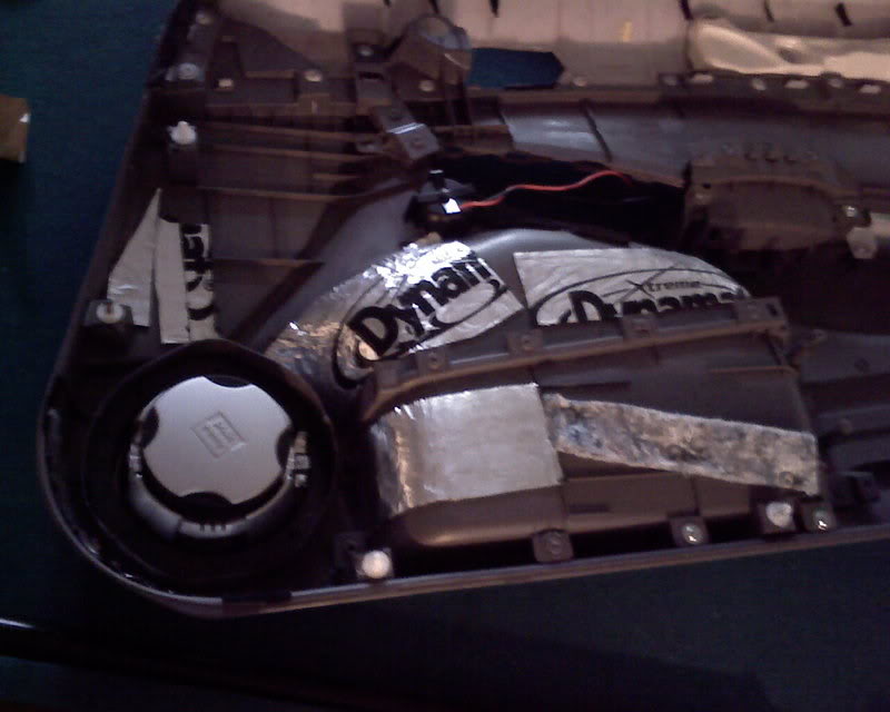

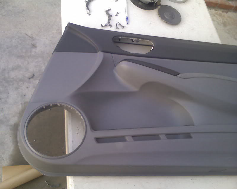

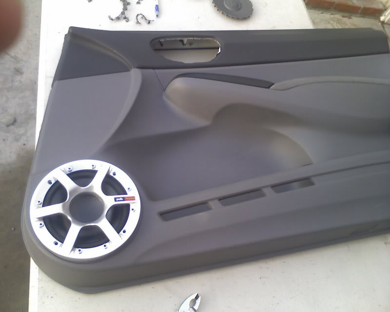

Here are the doors which ive had done

Sorry i dont have pics of the door without the panneling on.... but pretty much just picture 2 layers of dynamat extreem over EVERYTHING but the mechanical parts.
