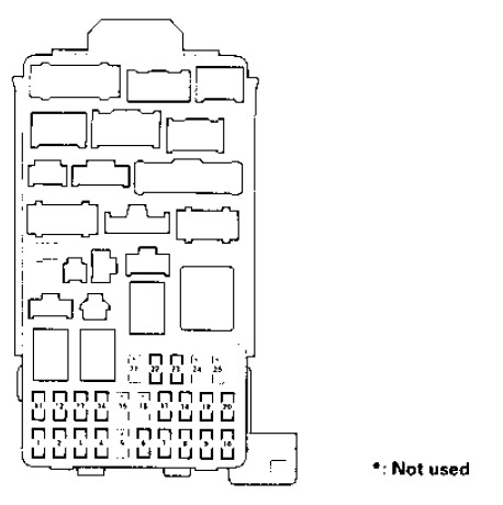

i have a 03 civic ex and id like to disable the DRL. I ran the vin and its from Canada. in Canada its mandatory to have the DRLs. I've tried pulling the fuses under the dash, but that didnt work. Any ideas???

Did you try removing fuse 3 and/or 12?

I did im trying to find the relay and just pull that but i have no idea where its located...??

http://www.lightsout.org/disable.html#Honda
1997 and later Honda/Acura. To disable the highbeam DRL for all Hondas/Acuras 1997 model year or later, just look for the DRL fuse in the fuse box under the dash. It should be a 7.5A fuse. There is another one that is 10A, but it doesn't need to be removed. This worked for both my 1997 Honda CRV Canadian version and 2004 Acura RSX
You sure you're not pulling the wrong one?

tried that still coming on when key is in the "on" position...
