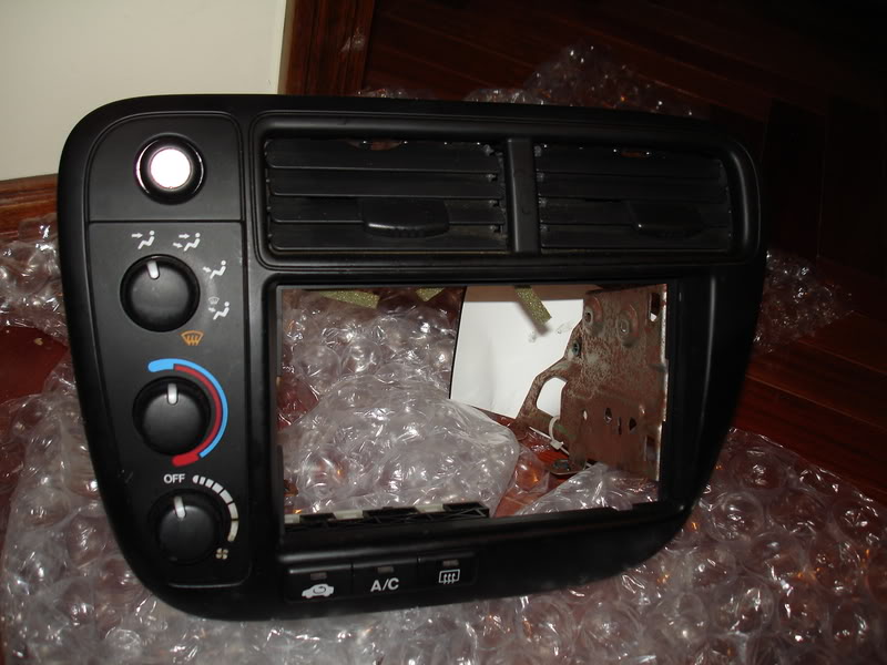

yep very similar only difference is the screws behind the bottom middle console going up holding the radio/temp bezel in place. the 99-00 use 4 bolts going straight up and then you can pull out the audio console.
the audio console will come out as one piece like this.
just unplug the wire harness plugs and when you pull the radio you have to remove the side temperature controls to access the side mounting screws on the left side.
and just be sure to use the right length screws for your radio when mounting the new radio!
i had to drill my holes a bit larger to mount my double din radio out the front just a bit more.
so if it doesnt fit just drill the holes in the metal mounting bracket a bit more to fit the radio just like you want it!
