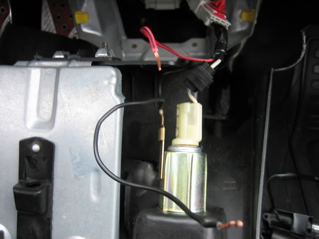

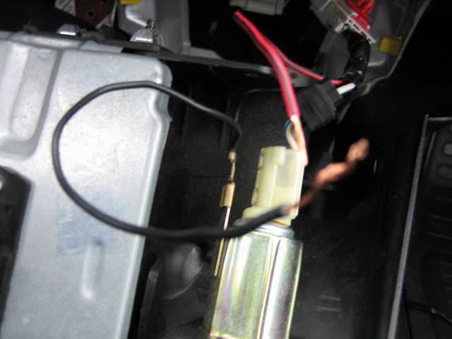

i took my neons out of my car cuz im gena sell em. after i took em out, i went to turn the car on and guess what...no head unit...i dunno what the hell happened. i messed around with the wiring and still nothing. i need ur guys help. i took pics of the part that i messed around with and i need to know how it was back before i ever had neons connected.

if u could get a pic of what ur setup looks like or tell me where each wire goes then thatd be great.

na..i found out the problem...well for one that black wire is a ground wire so i need to ground that. the red/black wire is just for a lil light that goes to a try, which i dont need.. and i looked at the fuses and found the blown one. so ill be going to radioshack or w/e tomorrow and hopefully get the HU working again...

ya i was about to say most likely ya just shorted out the wire and blew the ignition fuse.
easy fix...
but next time you add anything extra to your car be sure to put a fuse on that extra wire!
that will prevent you from blowing your stock fuses and messen up anything else.......
