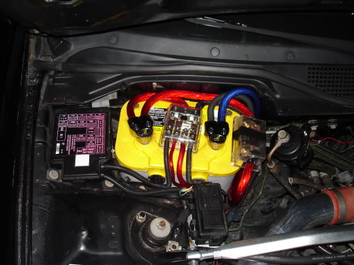

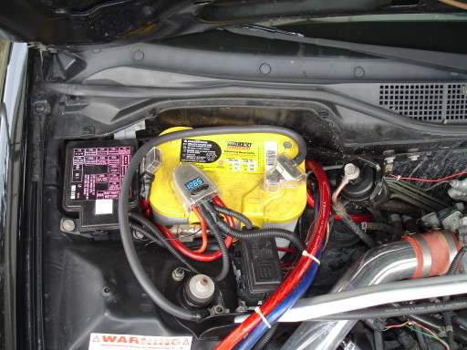

thats why when i changed my battery terminals and wires i took the safe route and added a fuse block to replace the factory fires since i had changed the routing of the factory wires.
from this mess with just changing my terminals
to this cleaned up and all properly fused
tho that right thier just terminals and fuse blocks still cost me about 100bucks not including wires.... which i still want to replace with matching color wires....
not only does it look alot nicer... its alot safer!
reminds me i still gotta buy a new main amplifier fuse holder... i keep forgeting... my old was is just ugly.LOL
