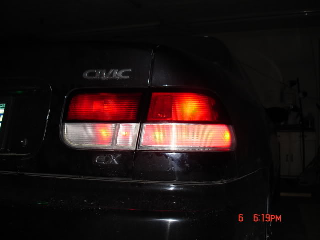

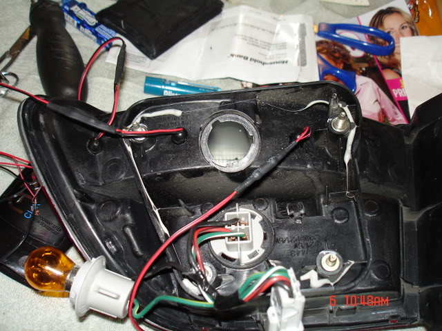

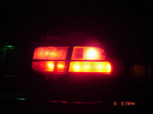

you trying to do them like mine?
but just wire them in with the stock lights just fine...
but depending on how many ya put in thier.... but dont expect them to be extremly bright......
main reason i used them is cause they are colored and the color wont fade!!!!!!
i just drilled a hole large enough for the leds to fit in and then used some HOTGLUE to seal them and hold em in place...
BUT in my pics... remember my upper taillights are tinted so they do look brighter...
