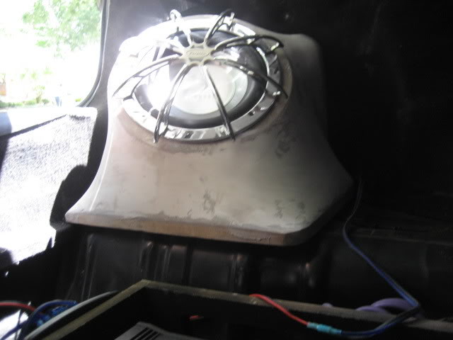

the floor is made out of 3/4 " MDF covered in suede..... and yes i did make it.... i built the boxes awhile before.... but i did the floor in one night after work .. probably 2 to 3 hours..... i'll have to check if i have some build pics of the boxes.....

this is all i got on my home computer

That is some top quality work. Thanks for posting pics. I want to do the same setup, im just wondering how to build those corner boxes

i started out with a mdf base then built the back side up about half way.... then cut out a ring and support it with some standoffs ... back strap strips of wood whatever you have around....then stretch fleece over it and resin it.... when it's hard start laying glass down.... then bondo and sand... thats about it
