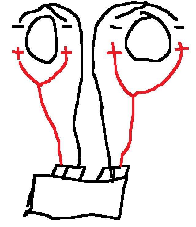

Ok, so I have 2 DVC 400w RMS @ 2ohms subs, and a 2 channel amp rated at 800W x 1 @ 2ohms. I wired the subs by taking the 2 positive wires (and 2 negatives), twisting up the ends, and using a connector to attached them to the terminals in the box.
My question is, should I wire them a different way? (I saw a diagram of attaching one positive to the other positive terminal, then only running one wire to the terminal) If I should do it another way, diagrams would be appreciated. Thanks.

I can't see the the12volt diagram without subscribing to that site. I'll assume it is stil hooked up like your hand-drawn diagram. That wiring is not correct for the equipment you have. The amp is loaded to 0.5 ohms and it is not designed for that.
You need to wire the subs series-parallel. This means the two coils in each sub are in series, then the two subs are in parallel (which is done at the amp because the two sets of output terminals are merely connected in parallel internally). This gives you 2 ohms at the amp, in which case it is rated for 800 watts. The power will split evenly between the two speakers, 400 watts each.
If you had four ohm DVC subs, you could use parallel-parellel wiring (like your hand drawn diagram) and have one ohm at the amp, so it could deliver 1200 watts. But you don't. The two ohm coils must be wired series-parallel to not overload the amp.
