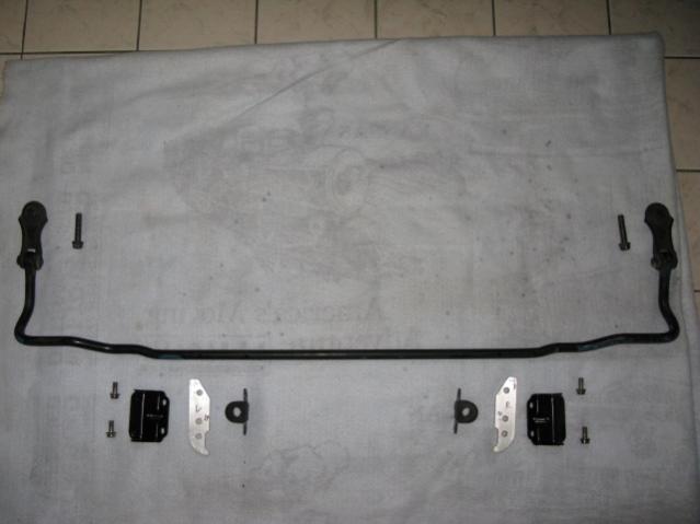

I got a 15mm sway bar from Del Sol (vtec).
But I still don't have the two rainforcement plates fro the subframe.
I call Function7 here in IL, and then in AR but no luck.
The Beaks plates are $70 for the set of 4. I think that's a little too much...

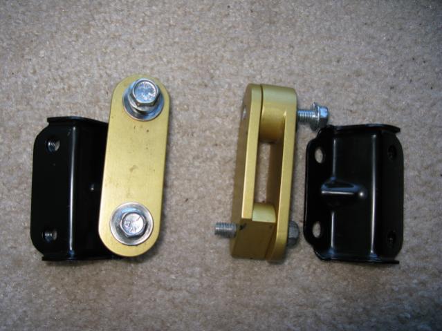

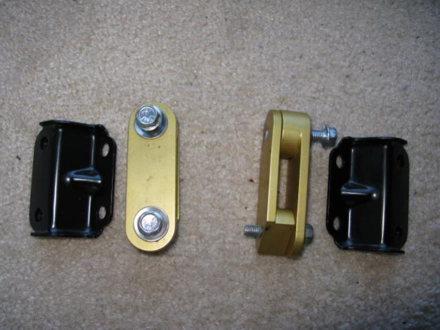

Got the bracket from '99 Si, right from the dealer,
and also a used set of the Beaks kit.
Does not seem to fit...
What's wrong?
The Beaks kit is not for my car or what?

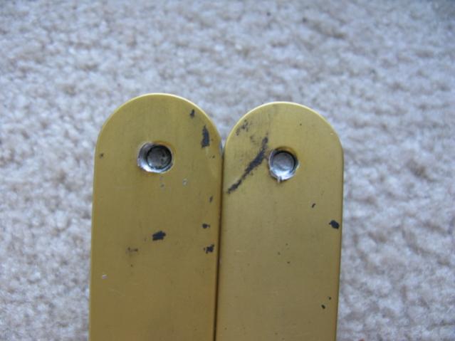

ALSO one of the thread hole on both planks is damaged.
Should I return the kit to the seller?
What's wrong?

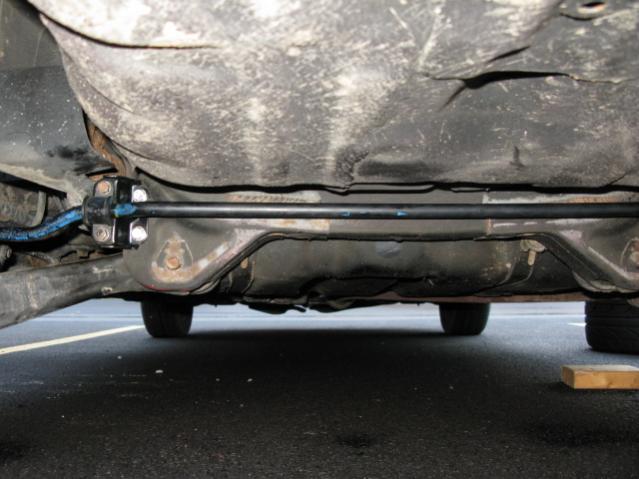

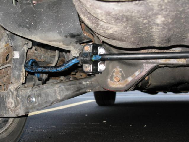

The sway bar is installed. :-)
I spent little extra money for sub frame brackets ($40) and reinforcement plates ($30) + the bar ($60). So 15mm rear sway bar from Civic Del Sol (VTEC), brackets from 99 Civic Si, and custom made aluminium reinforcement plates.
One major mistake I made - installed the washers and spring washers from the side of the bolt not the nut. The aluminium plates don't have thread so I have a nut behind.
Car feels much tighter when turning and the rear end squall a little with the old all season tires. I like how the car feels and turns more and easily.
Thanks a lot to all of you and especially to the civicexracer!!!
