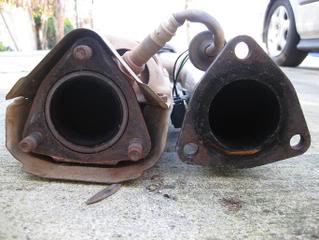

jw if you can use the flange from the upper header to the lower header turn pipe from the stock y7 one or if that flang would fit onto an EX stock cat converter? ..
cuz im doing the same setup with an EX header to cat. converter but i got a ctr mid pipe .. the flange on the ctr pip is too big for the stock EX cat converter .. so im jw if i can reuse that flange on the y7 on to the ctr midpipe since flange are hard to come by ..

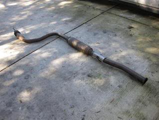

you got a picture of this CTR mid pipe? im curious to know what ya mean...

well i say it just looks like any regular mid pipe .. the piping is a little larger/bigger .. so the flange on it is bigger than the stock ones on the y7/y8 so it wouldnt just bolt onto the ex cat. converter .. thats why i was wondering if the flange on that y7 would fit the ex cat. converter .. 3 bolt flanges and all .. cuz if it does then i can jus weld that flange onto the pipe i have ... but ill take pix of it tomomrrow or so .. its dark here already ..

here's a pic of the mid pipe next to the ex cat. converter .. it looks like it would fit but the flange is a little wider on the pipe so it wouldnt fit ..

well hard to tell exactly how much its off BUT if the bolt holes are just slightly wider simply drill/grind the holes a bit larger. doesnt look like its off to much.... if in doubt of sealing use a high temp flat gasket also between the 2 flanges.
