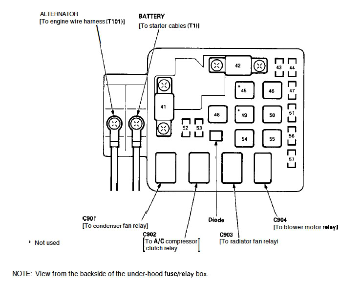

Regarding the lack of communication with the scan tool, check whether fuse 43 is blown under the hood:
Old Jul 8, 2008 | 09:05 PM
T_Carps's Avatar
Posts: 4
Default RE: ECU Problem
i checked both #43 and #15 fuses and there both good and the CEL didnt work it stayed on and theSRS light stayed on

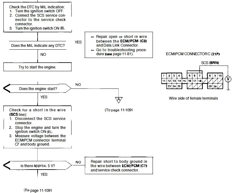

I assume that the engine runs. Is this correct?
If so, check for a short in the SCS line as described in the diagram below:

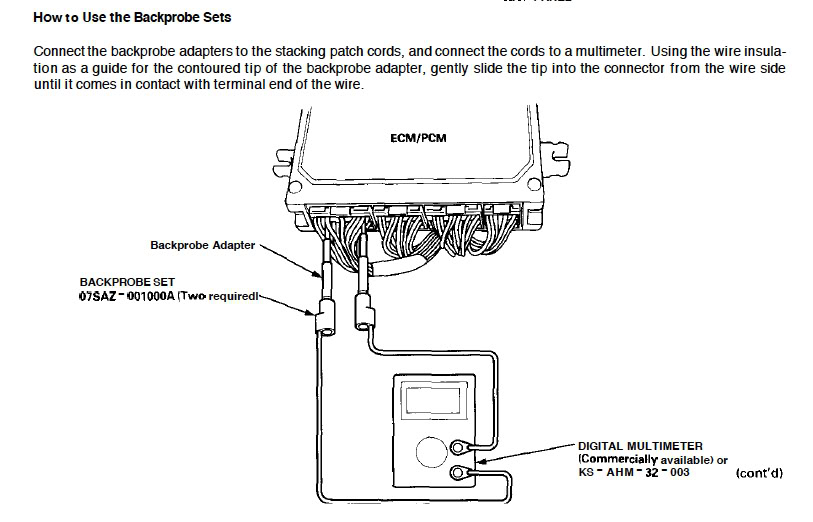

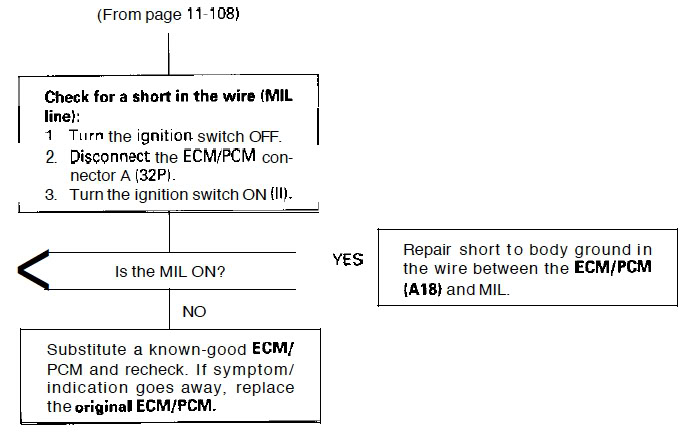

Okay, check the voltage between ECU connector C, terminal 7 and body ground (see diagram). With the ignition key turned to ON, your multimeter should read 5V.
Edit: This step requires back probing with the multimeter:
