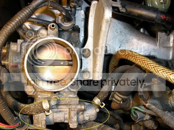

Yeah mine is on the throttle body.I'm thinking it might be the fast idle valve because i just plugged the hole on the throttle body with my finger and the rev's went down and were steady. As soon as i took my finger off the rev's were serging again. Now i need to find the fast idle valve on my engine.Its some where under the throttle body.Thanks
Old Oct 5, 2009 | 02:27 PM
here is your fitv

Check to make sure it is sealed up. I had a very small coolant leak right where that hose connects to the front of it, and once I fixed that my surging went away. Any extra air coming in will cause the idle to surge.

On my engine that's where the idle control valve is.It has electrical plug on the end,look a lot like the FITV.The guy at the parts store said they don't make FITV for my car...probably why i couldn't find it.I tried cleaning the icv twice with no luck.Im getting feed up....might just take it to the shop.Thanks
