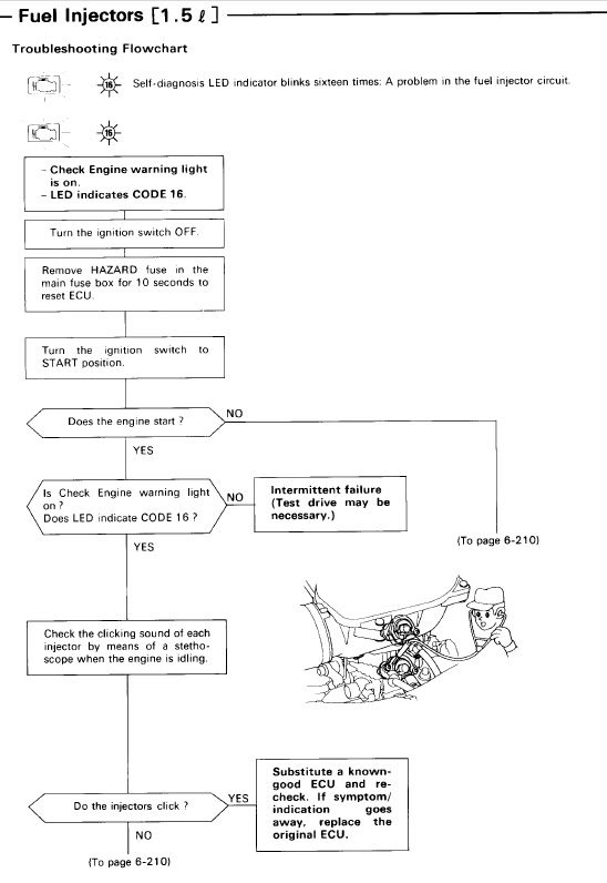

I just bought a 1989 Honda Civic HB DX w/ DPFI for my wife. Every once in a while the car just turns over and won't start. I swapped out ECU from PM5 to the one out of my wrecked HB which is a PM9. Didn't make a difference. The ECU is throwing a Code 16. What does this stand for? How can I fix the problem? Thanks for your time, please help.

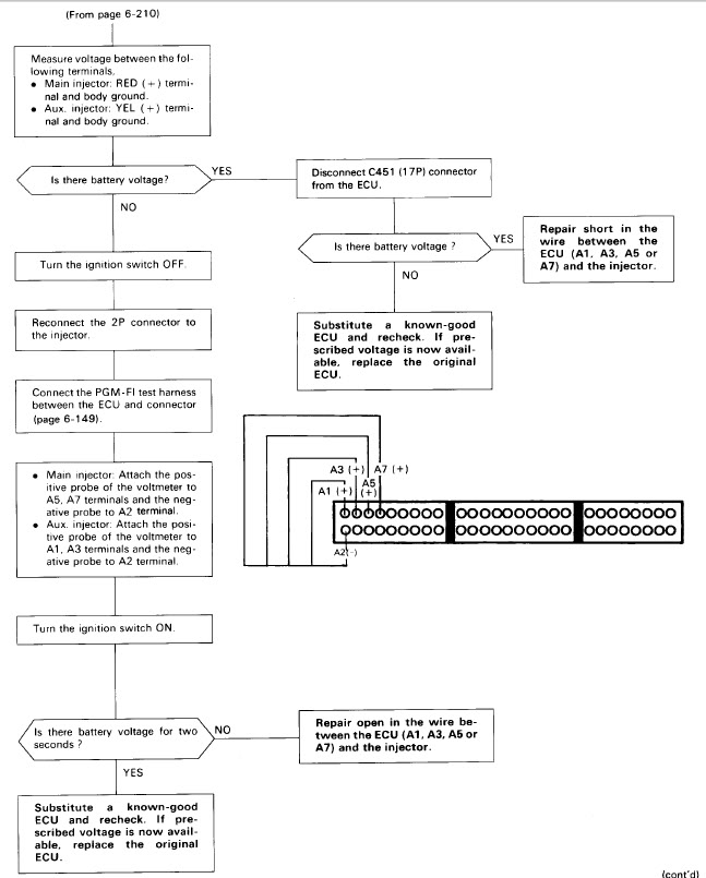

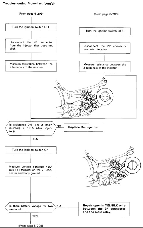

Also, have you tried measuring the resistance or voltage at the fuel injector or fuel injector connector, respectively, as described in the diagram?

That chart is very useful...Thanks for that...
