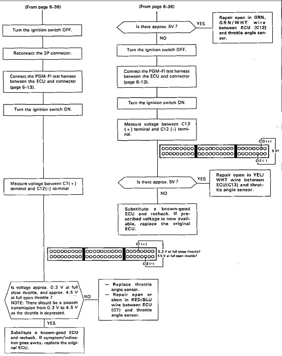

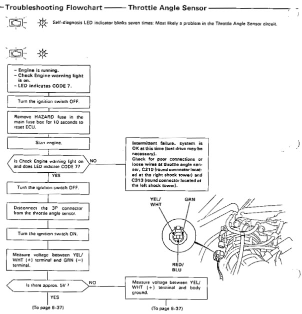

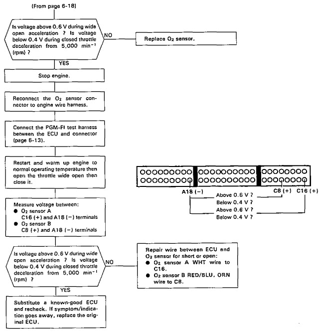

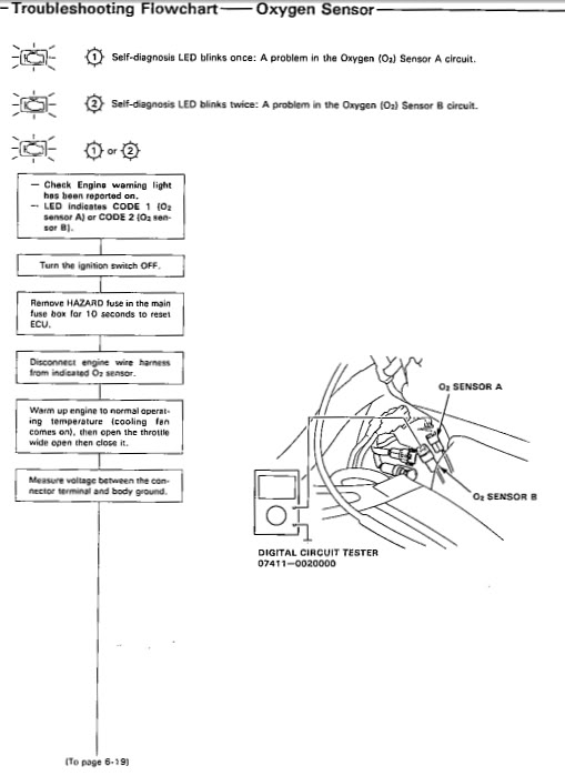

If the problems are not due to a swap, then the CEL codes point to problems with O2 sensor A and the throttle position sensor on the throttle body. Start by clearing the codes from the ECU by removing the HAZARD fuse for a couple of minutes, reinserting it, and then driving the car to see whether the CEL codes repeat. if the codes repeat, here's how to troubleshoot:
