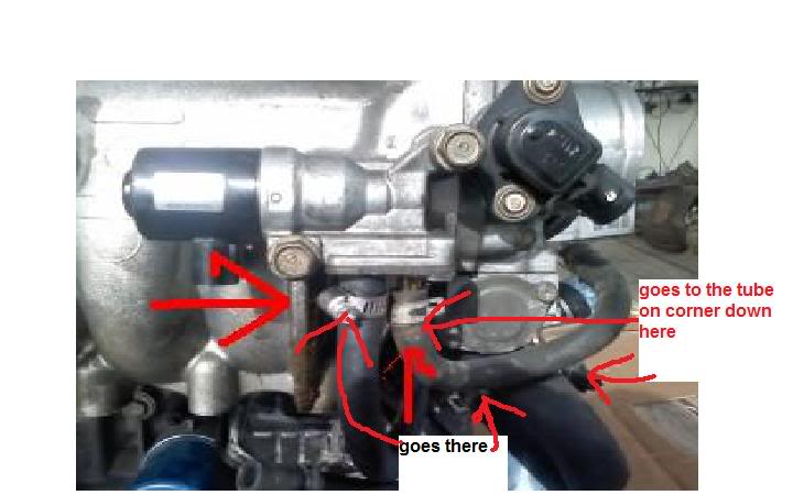

They arent on the tb they are on the back of the intake manifold, and he's wanting to put a 6th gen intake manifold on his 5th gen,

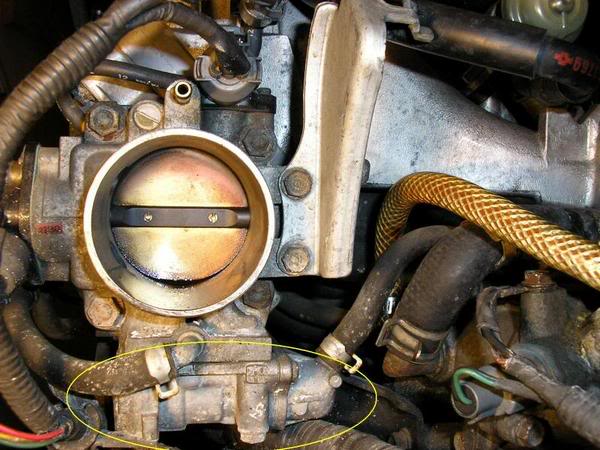

IACV is on the back of the manifold, FITV is on the throttle body.

i just wanted you to post a pic so i can circle stuff and explain that the iacv is on the back of the intake manifold not the tb, and the y8 intake manifold doesnt have the iacv needed only the manual one does.
this is the fitv

and this is the iacv
