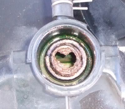

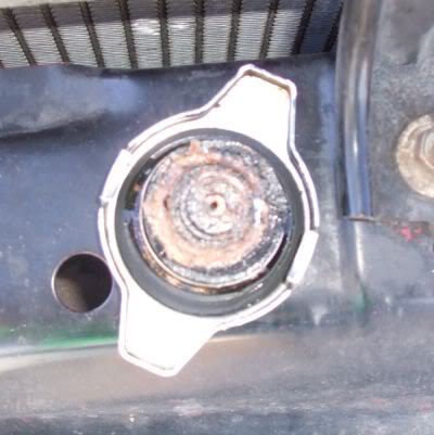

well.. i think i found the problem! i went to add the coolant so i could get her running again and well i saw this!

sweet huh? i was lazy any didnt want to fix my return water neck about a week ago because it was leaking coolant when i drove on the highway. i figured the minor leak could be fixed by the Bar's block seal stop leak (the expensive one that you can use with coolant), and on the back it states it can fix any leak.. well i guess the pressure regulator on my radiator cap was considered a leak too. and that is why the hose blew off... long story short.. DONT BE LAZY and dont use the stop leak.... now time to contact Bar's
