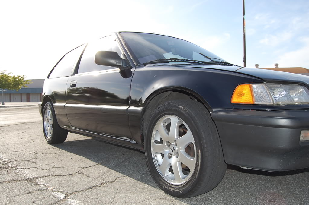

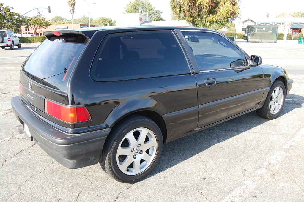

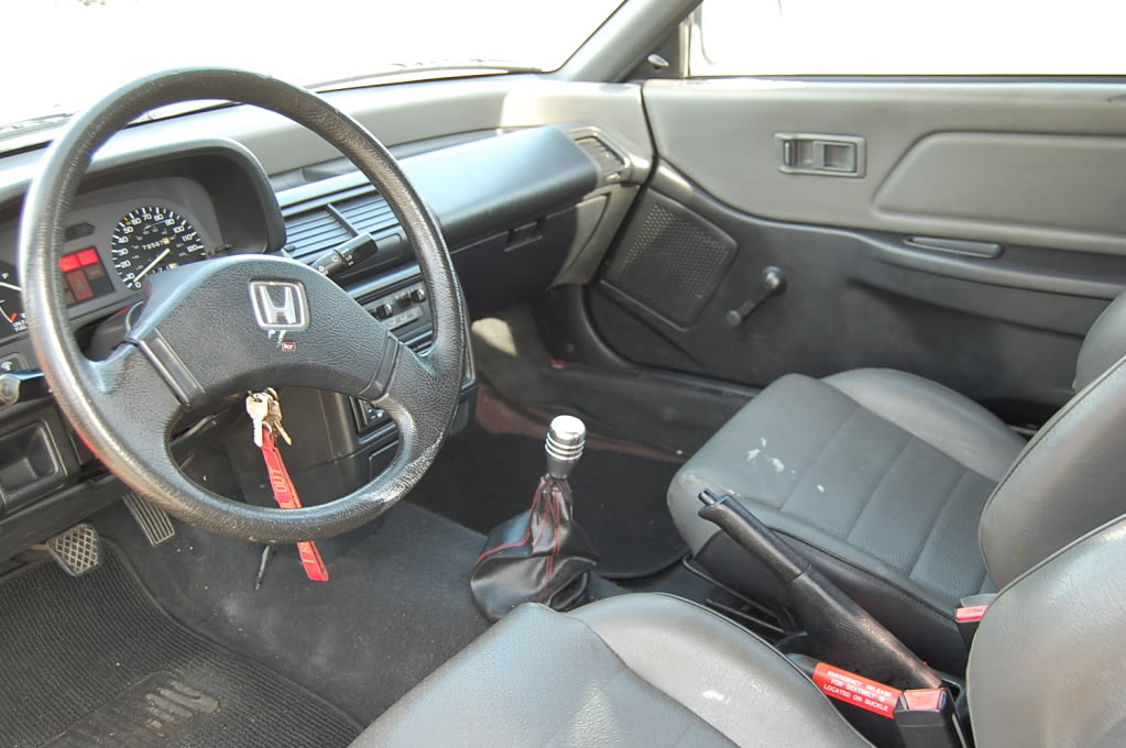

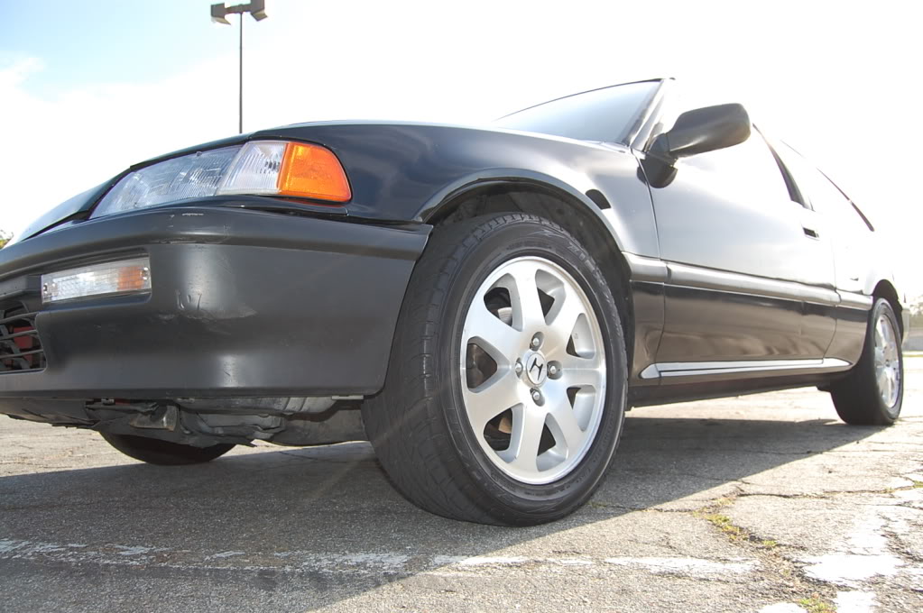

btw here is pics of my civic. i got it for 400 macco maint for 200 and wheels and tires for $150 lowering next! no engine mods will be done.
